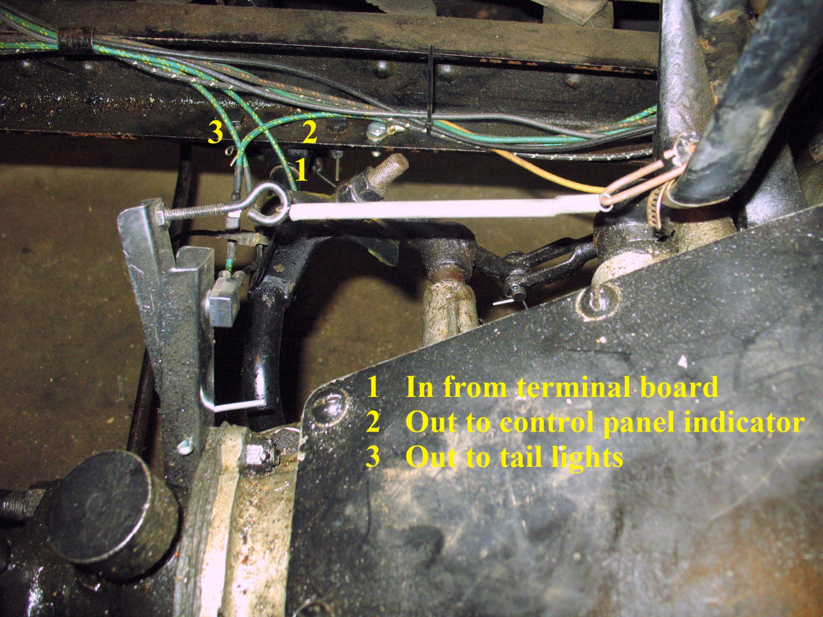

It's not difficult to make your own switch. 1: sheet metal scraps to make a "body" and lever. 2: spring attached to the pedal shaft and the lever. 3: The least expensive push button temporary switch from the hardware store. When you step on the pedal, the spring pulls the lever against the push button to turn on the brake lights.

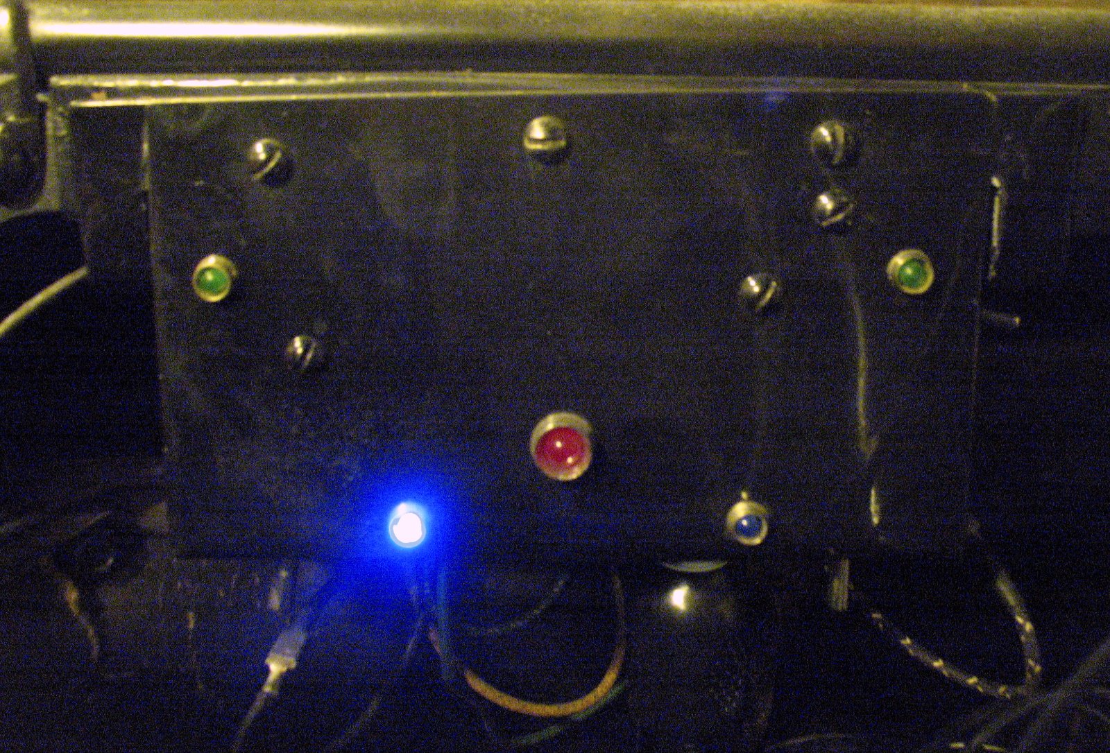

Home made control panel. The left blue light is the brake light indicator.
