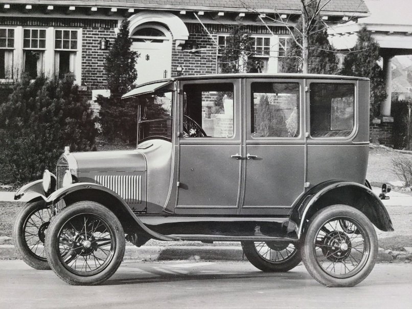

I am currently restoring a '27 Ford sedan. We came across the same page of that brochure. I also was looking at a factory promotional photo and it certainly looks quite like a satin finish to me. My inclination is to copy the finish of the car in that photo. I'm looking at the finishof the fenders compared to the body. Interesting.
27 Fordor satin
27 Fordor satin

Hi Eric, I think if you plan on showing your car, I would use glossy paint for the black and a satin finish for the body color. Just my thoughts, Russ Furstnow

The low gloss of the lacquer can be seen even in black & white photos against the high gloss enamel on the fenders & running boards.
