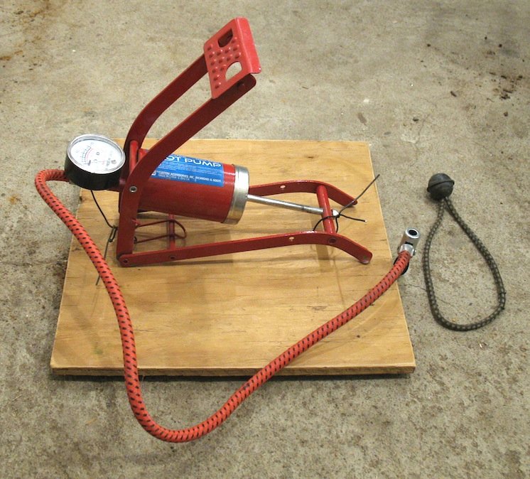

Speaking of Royce, it was his suggestion that led me to the bicycle foot pump I carry. I was dubious, but found it surprisingly efficient.
I wire it to a piece of plywood to keep it upright on uneven ground.
