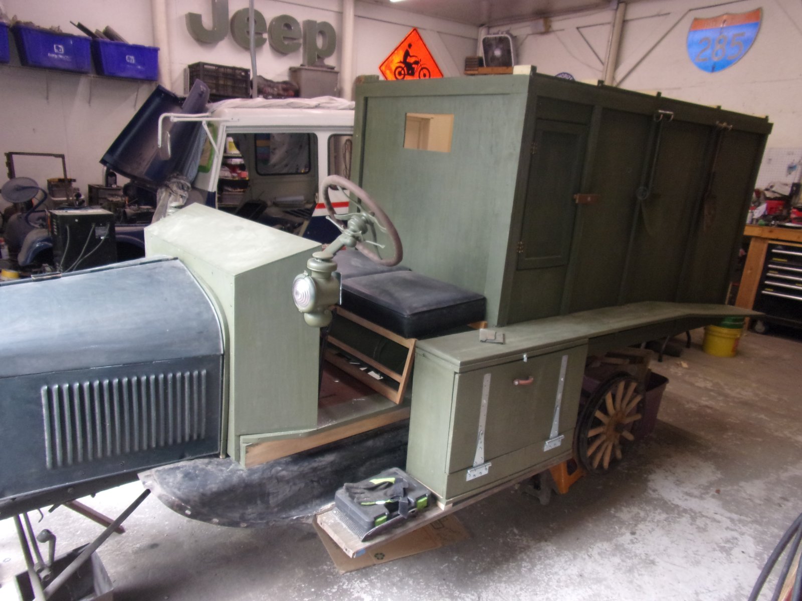

Front fenders are off my ambulance project and up at the sandblasters, but walking by the front of the T this morning, I had a sinking feeling and might as well know now if I have an issue. I have installed a radiator shutter more for appearance than purpose and now I wonder if the 2" that it adds to the front of the radiator shell will cause a fitment issue with the headlight bar running from front fender to front fender.. If someone has a 26/27 with the headlight bar, can you give me a quick measurement from the back of the bar to the front of your shell? Hopefully more than 2".
Thanks in advance. The project is coming along.

Drats. Probably need to wait until I get fenders back and can bolt them up prior to painting and feel what I got. Since I am using this 26/27 depot hack as my donor vehicle for a 1917 replica ambulance, the bar is not correct for that 1917 look. ?Wonder if I can do something with bolting the headlights onto the feners and eliminating the bar or cobbling up something myself with the tube bender that would have a forward leaning offset to go in front of the shutter. Or, I could go totally military and make some sort of brush guard.
Where does it stop?
Thanks for the input. Just something to add to the project list..

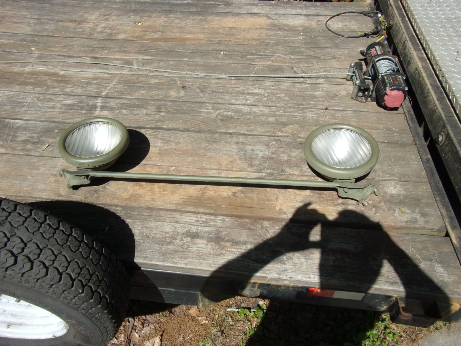

Hmmm... so here is what I got. Could use some direction.
Feeels like bar is seperate unit from two holes in fender to two holes in other side front fender. Head light feels like bolted to bar seperately. If I remove the lights from the bar, I'm not seeing holes in my fenders to mount the head lights directly to the fenders or to allow fender irons or light mounting rods to pass through fenders.
Read a recent post about a member asking about 26/27 fenders and I thought I read there were no differences between the two. But, how would head lights with no bar mount to a 26 fender and how would I mount head lights directly to these, apparently, 27 fenders?
I'm still visualizing cutting the bar between the fender and grill and letting the head light remain in place and then welding on a forward bent tube to pass around the front of the radiator shutter and grill. Although, free standing head lights would be closer to the look of a 1917 which is a plus, although my high radiator and rounded slatted grill are in contrast to that.
Thoughts? Is the 27 bar trade bait for two free standing headlights? And, if so, what would I need to mount free standing head lights? And, would the removal of the bar cause a fender or head light vibration issue? Presume there was a reason HF added a bar.

by Chuck Regan
Robert - attached photos of my January 1926 built RPU headlights and bar. As mentioned above, early headlights w/o bar or headlights with the early bar should work.

Chuck, you bar is not like the ones with which I am familiar. Perjhaps it is an aftermarket accessory. the bar is usually made just like the later bars which Bob already has, but his bar takes the later headlights which mount on the bar rather than at the fender.
Re: Need approx. measurement 26/27 Headlight Bar
Posted: Mon Apr 29, 2024 7:42 pm
by DanTreace
Allan wrote: ↑Mon Apr 29, 2024 7:33 pm
Yes
That style bar (Marquette) is for the early '26 fender post mount headlamp buckets, lots of companies came out with these prior to Ford being required to fit a bar and then Ford changed too the bucket design to mount to the bar for more easy adjustment of the lighting. The fender post mount '26 buckets have to be be bent with a wrench or bar to adjust the light beam.

Allan, Dan - thanks for the clarification and info regarding accessory front headlight bars. My truck has a front bumper - someone may have added the bar to display license plate.
