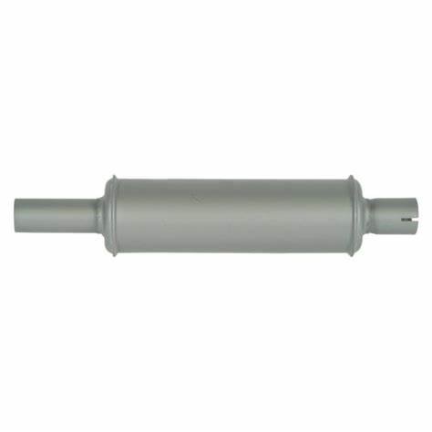

If you want to be “original” for ‘25, the suppliers sell a sheet metal muffler that attaches to the frame with one bolt. I believe the muffler picture Dave posted above is a TSC product. I recommend them and have used them.

Yes 4025EXS is it. They fit right, they look right, they sound right, install in pre-existing hole in frame, available from the usual vendors, Langs, Snyders, etc., easy peasy.
Larry has not made tail pipes in decades and there is not a secret stash someplace.

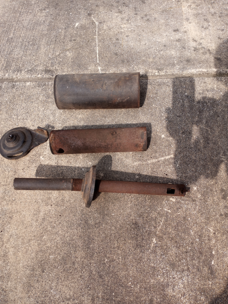

Here is what the original looks like. Sold this one to someone who was looking into reproducing them.
