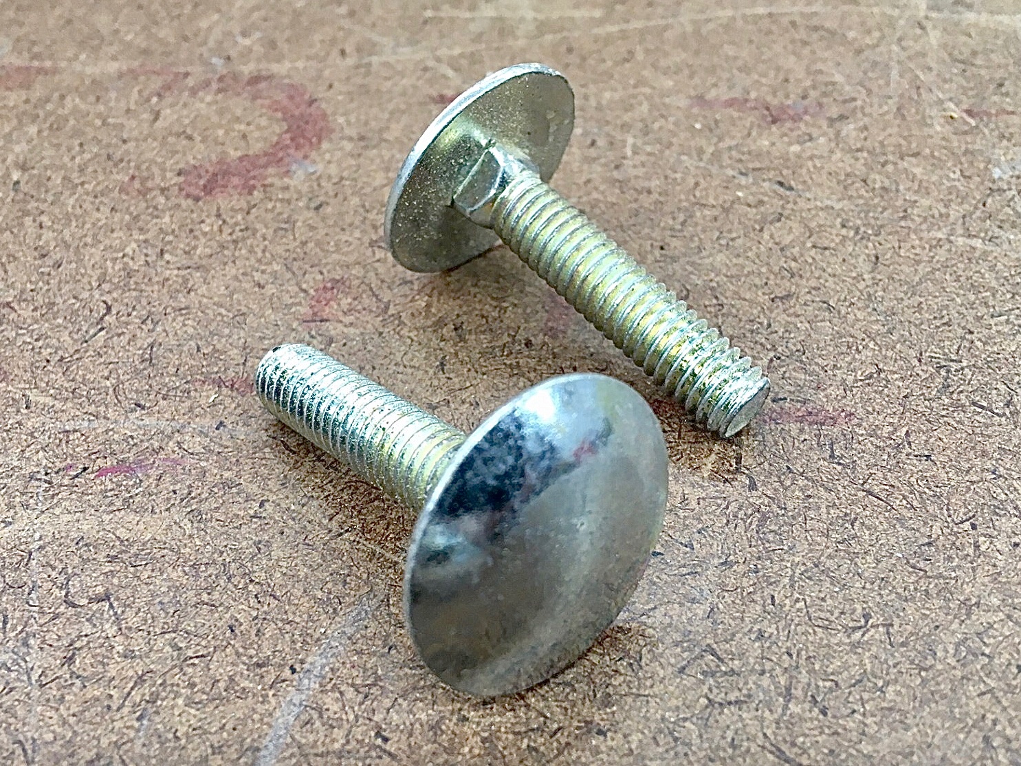

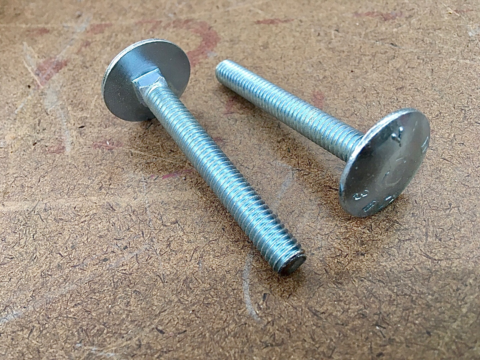

Re: 1915 hood former step bolts
Posted: Tue Apr 30, 2024 10:12 am
by Dollisdad
If you need a couple let me know. I have 5/16 X 1 1/2 and 5/16 X 2 1/2.
