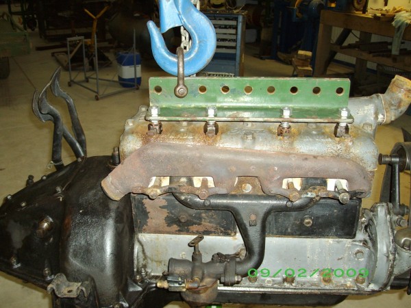

Herb ; I use this to lift the Engine

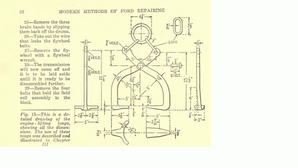

See Modern Methods of Ford Repairing, page 38.
