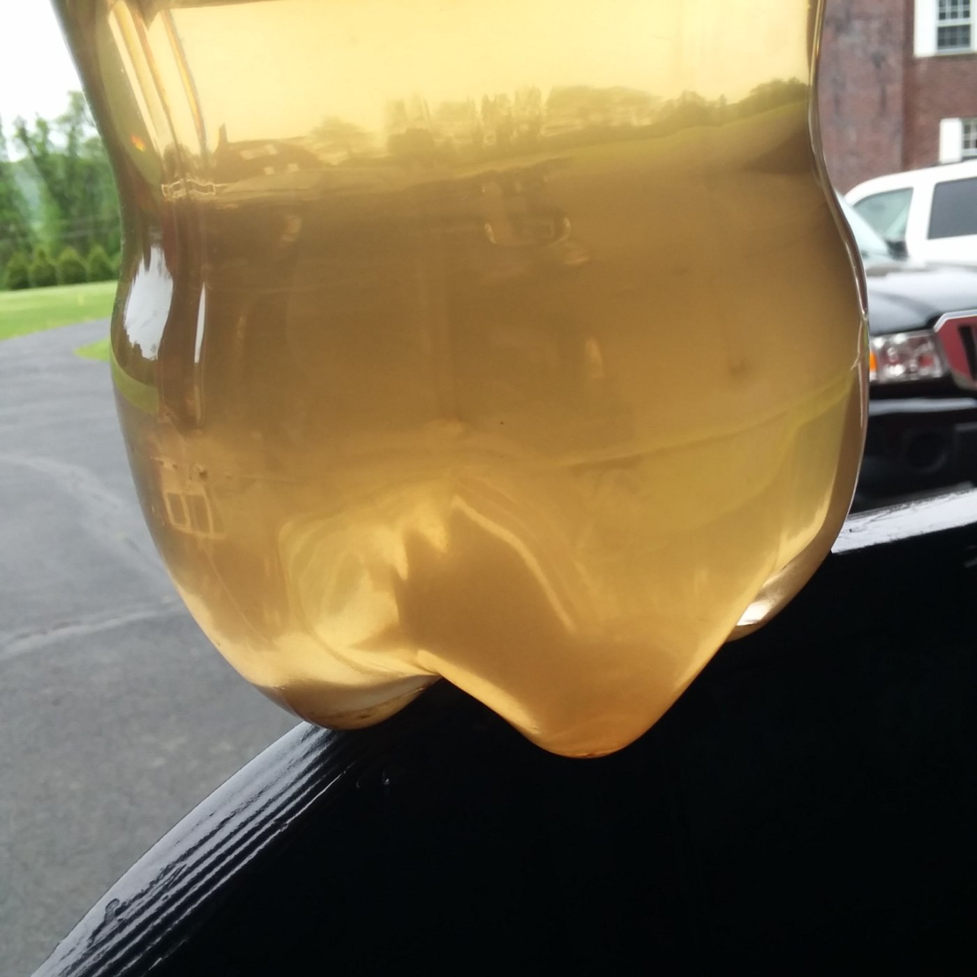

Foggy fuel isn't helping any either.
More work to be done tomorrow.....
Checked a bunch of things today. Will start it tomorrow after more work.

Issues all resolved... water in gas and a New Day having a "bad day." Drained the gas and refilled with fresh fuel, and I refaced the timer to clean up that mess. Car's running great again. I also regapped plugs, checked out the NH carb, and had my coils tested.
Evidently I made the mistake of putting the car away for winter without taping up the vent, and not giving the gas tank a healthy glug of MMO.
I've always done that and have never had a problem until now..... multiple lessons learned here, and with lots of kind help from friends both on the forum and off. Many thanks!
