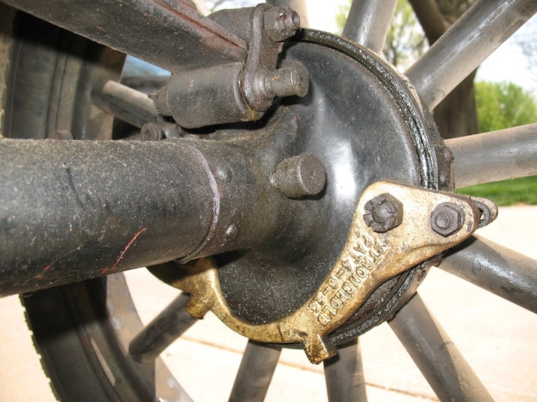

On my 20 roadster project, it has external rear brakes horseshoe type pad that runs off the parking brake handle. They are marked ADCO. Don't know if the pic shows much, but I really don't want to remove the wheel for a better pic. Just another aftermarket type of brake, I presume.
A bunch of old cars
Sometimes they run.
Sometimes, they don't.
Posts: 5602
Re: Accessory Brakes
Post by RajoRacer » Sat May 18, 2024 6:26 pm
Most likely APCO - they manufactured all sorts of aftermarket T parts.
