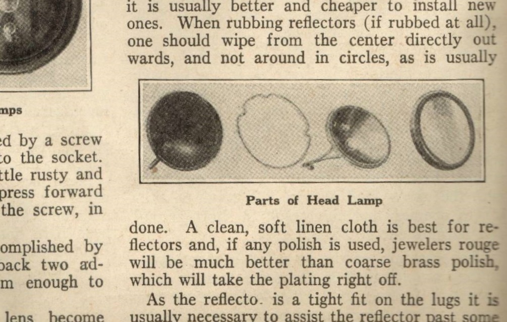

Nix on painting, preserve the silver plate. A good polish like Wright's Sliver Creme works well.
But rub and polish only from the center to the edge, in straight rubbing with soft wet sponge or wet chamois and polish.
Don't rub in circles .
These reflectors can be restored, maybe not as new, but fairly well and way way better than chrome paint.
