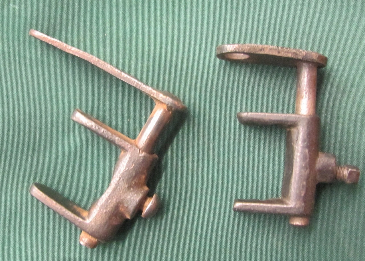

Cleaning up the parts shelf and totes today and this one has me stymied. Could be T, TT military vehicle or refrigerator ice maker.
I'll hang up and listen. And, if it gets ID'd and anyone needs it, I don't.

A couple of photos with scale would help. Looks to me to be a fan belt guide, but kind of hard to tell the exact size.

Yep, agree, you nailed it, an accessory fan belt guide to keep the flat belt on the fan and crank pulley.

Yes. It is a fan belt guide that straddles the fan belt and keeps the belt centered on the pulley, preventing the belt from going to and fro on the pulley. My 1926 coupe had a very rusted and pitted one on it when I bought it in 1970. The parts places sell a modern version of this from their inventory. The one in the picture is sold by Snyder’s. Jim Patrick

Thanks to all. Makes perfect sense. I have to pull my radiator when I get fenders painted and ready to reassemble the WWI ambulance project, so I'll see if I can figure out where to attach and put it on at that time. Don't see any downside to installing one.
