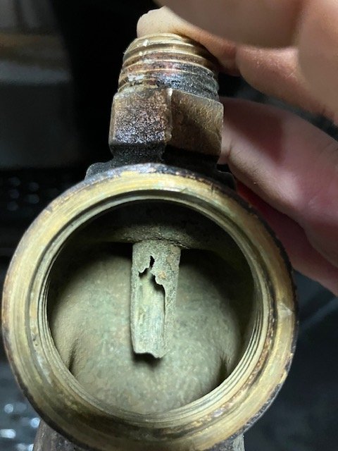

Well, I got my biggest pipe wrench and gave it some pretty hefty yanks, it finally let loose. The chunks of stuff is what I couldn't get broken up. What's the best way to straighten the bent valve handle? There wasn't a lead gasket, but appears to have a copper one. Will this work? The pipe inside the bulb, is the side missing an issue?

There wasn't a lead gasket, but appears to have a copper one. Will this work? The pipe inside the bulb, is the side missing an issue?sed pieces.jpgsed pipe.jpg
That internal pipe is part of the casting on early sediment bulbs, yours may have been slight cast defect, won't hurt the flow of fuel. Do use a new lead gasket, and solder a new round screen onto the large brass nut. Many times the later iron bulb and brass nut are hard to remove, so heating up the iron bulb at the edges of the brass nut (which will also melt away the lead washer) and then placing the hot assembly in the freezer will allow separation as the iron cools away from the brass. The melted washer will be replaced with new anyway.
