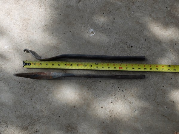

Having the right tools helps a lot. Before I tried mounting my first clincher a few years ago, I got the MTFCA video by Fred Houston on mounting tires. In it he showed using a special hooked tire iron that makes the job easier. There are no dimensions to it, but I showed the video to a blacksmith friend to see if he could make something like it. He made me three like shown in the picture below, from 3/4" spring steel. They worked really well. I mounted the tires with flaps on my living room floor. I used commercial tire lube that I got from the local tire store, and by the time I was done I was mounting a tire in less than three minutes after I had to tube and flap inserted in the tire.
Ralph

Re: Changing clincher tires with flaps
Picture didn't work; will try again.
Ralph

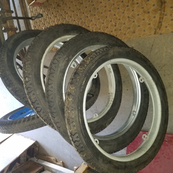

Well, mission accomplished with help from Gene; thanks a lot Gene!!
We removed and installed the tires with the rims on the floor. Stuffed the tube in the tire partly inflated after notching the beads for the stems, then levered both sides unto the rim together with tire spoons, using 4 hands and some liquid soap. At first we tried to insert the tire with flap and tube together as a unit but were unsuccessful. Ended up omitting the flaps entirely.
I estimate that all five tires (including spare) to remove and install took about three hours, with about a half hour of that total being due to a problem with a leaking valve stem that had nothing to do with the install.
Not an easy job by a long shot!

Mike Thanks for posting for some help! That's the real value of a forum like this which can find local help with our Model T's.
Changing clincher tires can be a challenge especially if you don't know the couple of tricks that help make the job a lot easier. I did see that your flaps really presented a real issue because of their size I think. We decided after inspecting the inside of the rims that installing flaps in your tires presented more issues than benefit. I've run clinchers both ways without any problems.
Some quality tire irons are a must. I have found the easy source is at the local Motorcycle shop. With nondemountables on my '12 I always carry a set for any roadside flats. It's a good idea to always have a spare tube. We had an issue with one of Mike's tubes that we were able to fix with hose clamp around the valve stem on his spare. Lucas sells tubes for $15. if we had one with us we could have finished the job but it was good to show Mike the hose clamp trick..
Was a good day and I was happy to help out a fellow Ter get back on the road with some new tires on his Very Beautiful '24 touring!

When our tires were made in the USA, I never used flaps, in fact, I never heard of them! I think I wore out about two or three sets of tires that were USA tires, Wards Riverside, and Firestone. Then I bought a set of Firestones that were made in New Zealand, and that's when the trouble started. I had three flats on the first tour I went on. I believe they must have done something to those tires that wasn't done before. At any rate, I now use flaps, and haven't had a problem since. I don't like them, and they are a pain in the butt, but they are necessary for the Viet Nam era tires.
- Posts: 3812
- First Name: Larry
- Last Name: Smith
Some more on flaps. They go in easier when new. I recently had to change one that had been in the car for years. They get a little tempermental after they've gotten hard.

I have stopped using flaps and pay more attention to tire pressure 50psi low as they go and not flat since
Use baby powder in tire and mount both beeds at the same time with tube just aired enough keep it round
1 hour work 4 new tires tube mounted
I mounted rhese for a friend having trouble and like other said if you where closer i say bring them by

Larry, I think you hit the nail on the head! My flaps were in the tires for almost 10 years and developed quite a "set" in shape making them very hard to remove (had to use vise grips and four hands) and almost impossible to reinstall.Original Smith wrote: ↑Sun Jun 16, 2019 11:43 pmSome more on flaps. They go in easier when new. I recently had to change one that had been in the car for years. They get a little tempermental after they've gotten hard.

Yesterday I finished mounting a new set of Excelsior tires on my 1911. I opted to not use the flaps that had been in the old non-skids for the past ten years. In those years I had two flats. Front 30x3 at 55psi, rear 30x3-1/2 at 60psi.
