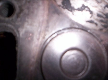

2 problems I've come across over the years with, 'for the big valve fit'
seats 011.JPG (30.28 KiB) Viewed 6491 times
are hitting the gasket and this one a few times.
The block will or can warp away from the valve seat from heat on the exhaust.
