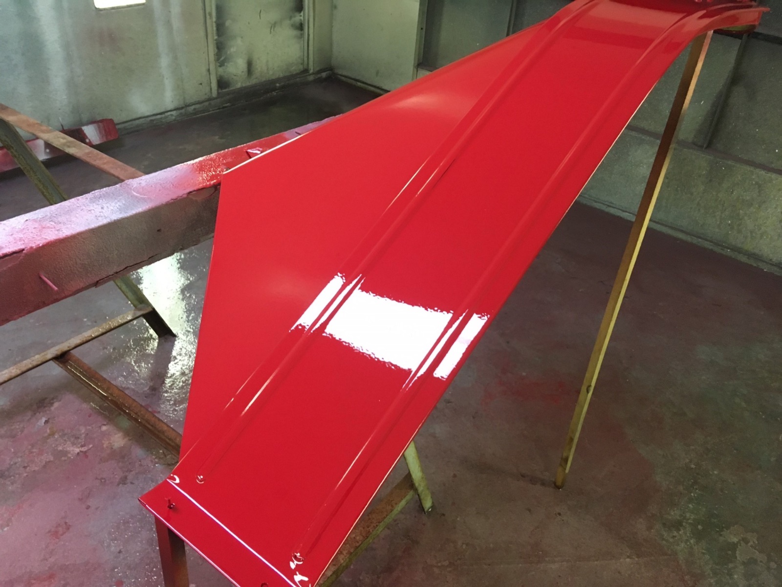

Got some new to me front fenders for the WWI ambulance which will get scuffed up and painted OD lusterless gree top and bottom. Paint with air compressor spray gun. I usually like to hang parts and spray both sides at once, but am leery of getting runs on top side of fender if I hang it by running board holes or frame flap holes. I'm thinking spraying bottom first, letting dry and then turning over and painting top side and letting it dry in that position to allow paint to lay down smooth. But I don't know how to prevent transition overlaps or ridges of paint along the top and bottom layers.
How do you guys and gals do it?
I'll hang up and listen.
For what it's worth, these have been painted well, so I will scuff them up and go right to od green, no primer. Light tack coat, medium coverage coat and then even top coat.

I nail them in their normal position to a 4x4 with 1x1’s holding the nose and tail in position, so you can shoot the top and bottom at the same time. You are less prone to runs this way than hanging them by their tail. Good luck.

When I painted my sheet metal I used saw horses with some plywood strips and a couple of 1x4 boards. It’s kind of what Dollisdod did or similiar.
The fenders were flat along with the splash shields and running boards to allow for less runs.
I would suggest that you first PRACTICE ON SOME TYPE OF TIN OR OLD FENDER TO GET YOU PAINT STROKES AND SPEED RIGHT AND THE RIGHT AIR MIX AND PRESSURE. Don’t mix your paint and hook up your spray gun and get going BEFORE and expect it will be OK. It may not be!
Be sure to paint the bottom sides FIRST!

I guess what I'm hearing is that the bottoms are painted and then they are set on some sort of support to simulate the mounted position and then the top is sprayed. Are the bttoms allowed to dry, then stand up and spray the top? Wet paint on the bottom touching the supports? But i'ts the bottom, so will not show?

Paint all the underside, then paint all the tops the next day.

Get an old table or saw horses with a piece of plywood to sit it on. After cleaning and preparing for painting, turn the fender over and prime the underside first. After the primer dries, apply several coats, allowing each coat to dry thoroughly, sanding lightly between coats using 400, then 600 wet dry sandpaper. When done, mask the newly painted underside with newspaper and masking tape to protect from overspray.
Turn over and do the top the same way after sanding off overspray from paining the underside.

I've always used a Binks spraygun, with the fender between two saw horses.

Impossible to avoid dust without a booth. I did all the stuff a nonprofessional would do. Made a visqueen booth, cleaned parts and supports with a tack rag, watered the floor and still got a lot of dust. The key to a good outcome is color sanding and buffing.
