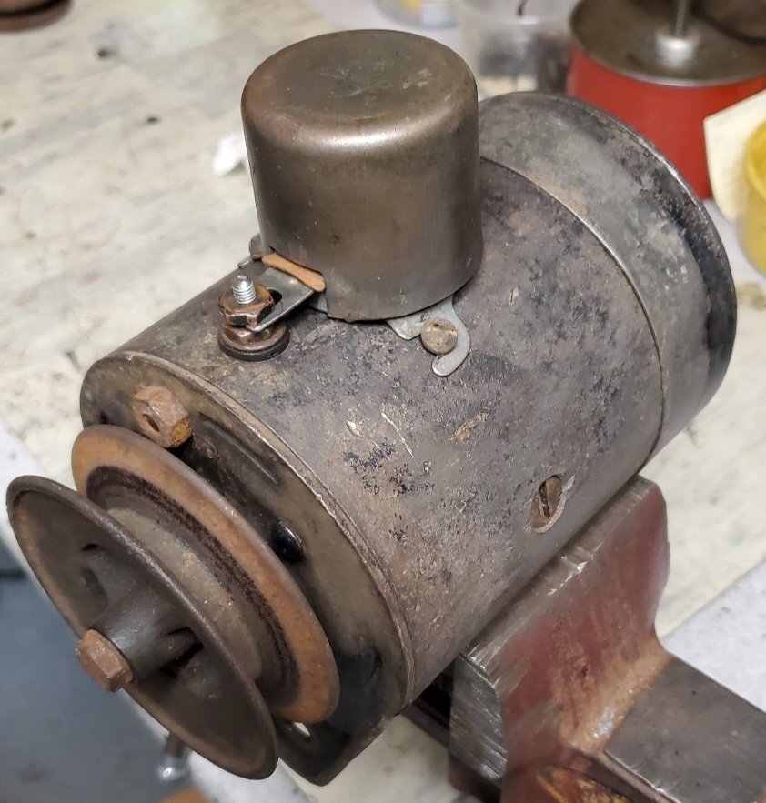

I know that model As used both copper and zinc plated covers on cutouts up through about February 1929. Late model Ts use the same cutout, but where their covers copper or zinc plated also?
I rebuild generators and refurbish original cutouts. I'll use copper cutouts on some early model A generators, but would like to know if I can use them on late T generators also.
This is an example of what I do.
Thanks,
Steve

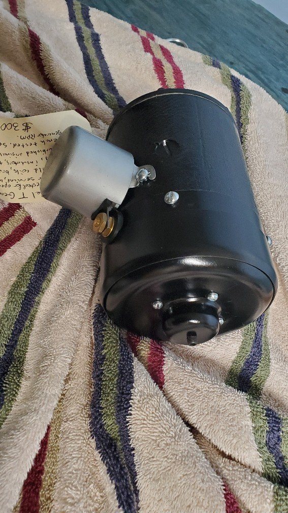

Dan - thanks for the reply. I had seen another comment by John mentioning copper covers, but not that one. I've refurbished a lot of cutouts. But only a few were copper plated.
Here is a nice original one which was serviced and adjusted, then used on a early model A patina restoration generator. I made this one specifically for a survivor car. Also shown are two refurbished cutouts.
Steve
