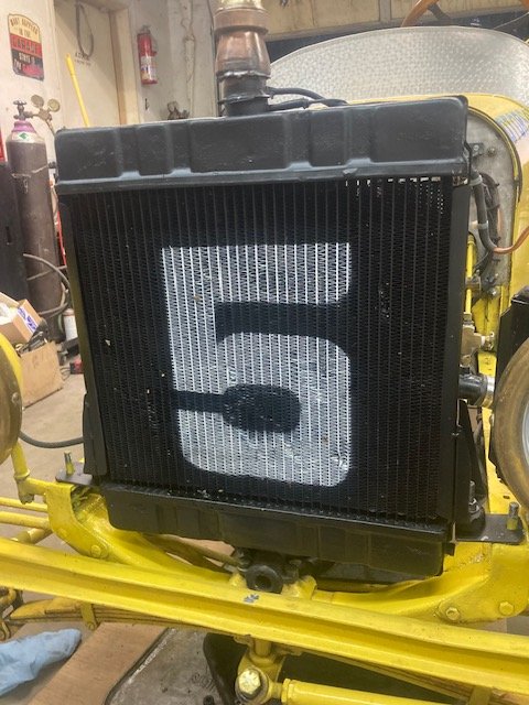

For what it's worth, I'm in my second season of running a Ford 9n tractor radiator on my speedster.
Buying a new T rad was out of the question for me so I had to come up with something.
It's a copper rad so it was within my capabilities to change what had to be changed for it
to work. The $169.00 price tag was a bonus. Works good, stays cool... It's not "plug and play"
but worth the effort.
Re: Aluminum radiator
Posted: Thu Jul 18, 2024 1:26 am
by Craig Leach
Hi Randahl,
Great idea, I looked at that but don’t think it will work out for a low radiator application. Glad it worked out for you.
