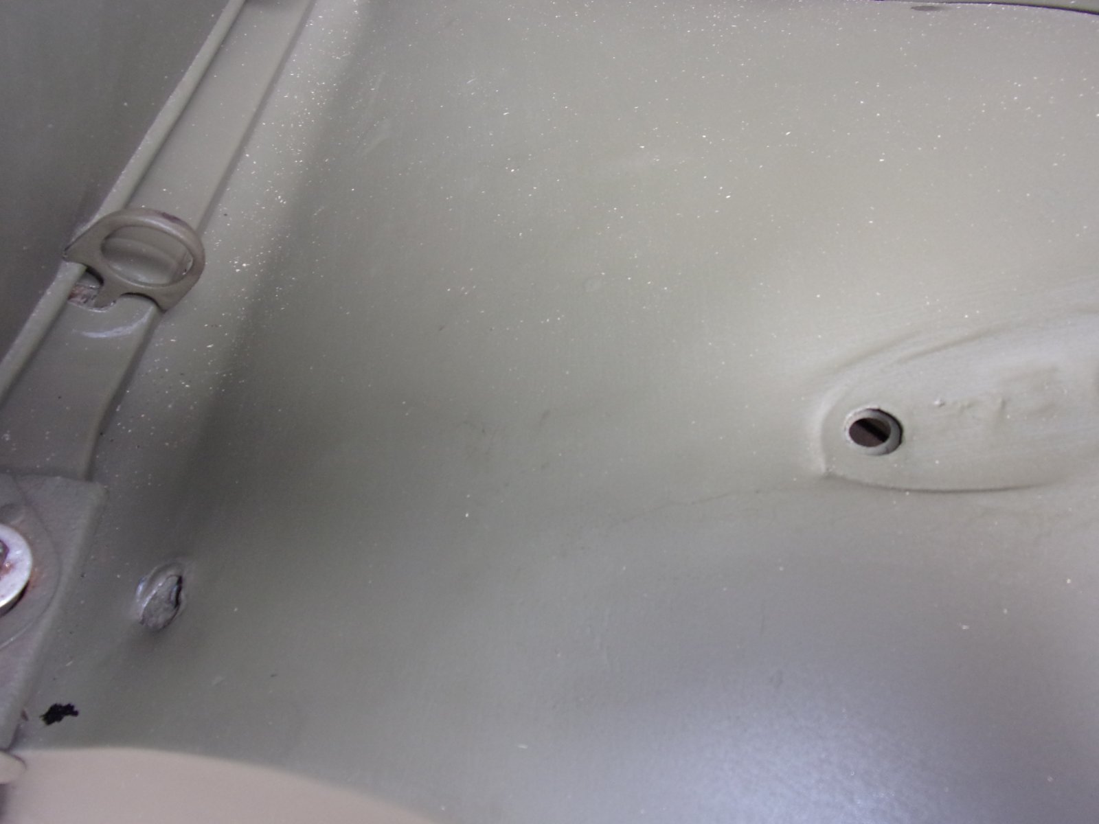

Forgot I took two original front fenders to Dan Hatch and didn't have them laying around to photograph. Removed replacement bolt I had installed and took pic. Feels like round hole and round hole in frame bracket as well, so no square shouldered bolt. I did have a few slotted button head bolts that look like carriage bolts but do not have square shoulders. Will only tighten as much as friction allows, but it's the correct appearance, I presume.

This earlier post will help. Photo shows accessory Ford bumper bracket using one of the frame bolts to th fender bracket. The top hole is for a large head carriage bolt that fasten the fender, the fender hole is usually worn too by this carriage head bolt, paint the head same as the fender,
