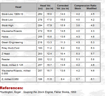

"High Compression Heads" are not necessarily that much higher than a low stock head but offer different performance characteristics.
Iron or aluminum?
compression ratios.png (105.2 KiB) Viewed 2455 times
Giant Haibe Simmons & Z
