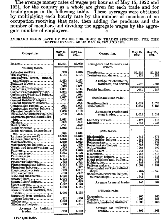

Well looks like it was a few days wages from "Union Scale of Wages and Hours of Labor, May 15, 1922 https://fraser.stlouisfed.org/files/doc ... 5_1923.pdfJones in Aiken SC wrote: ↑Tue Aug 20, 2024 5:23 pmIf those prices are from 1922, a tire must have cost a day's wages (or more)!
