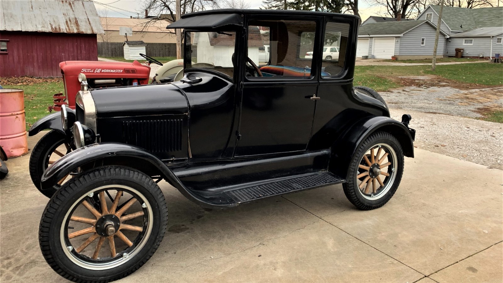

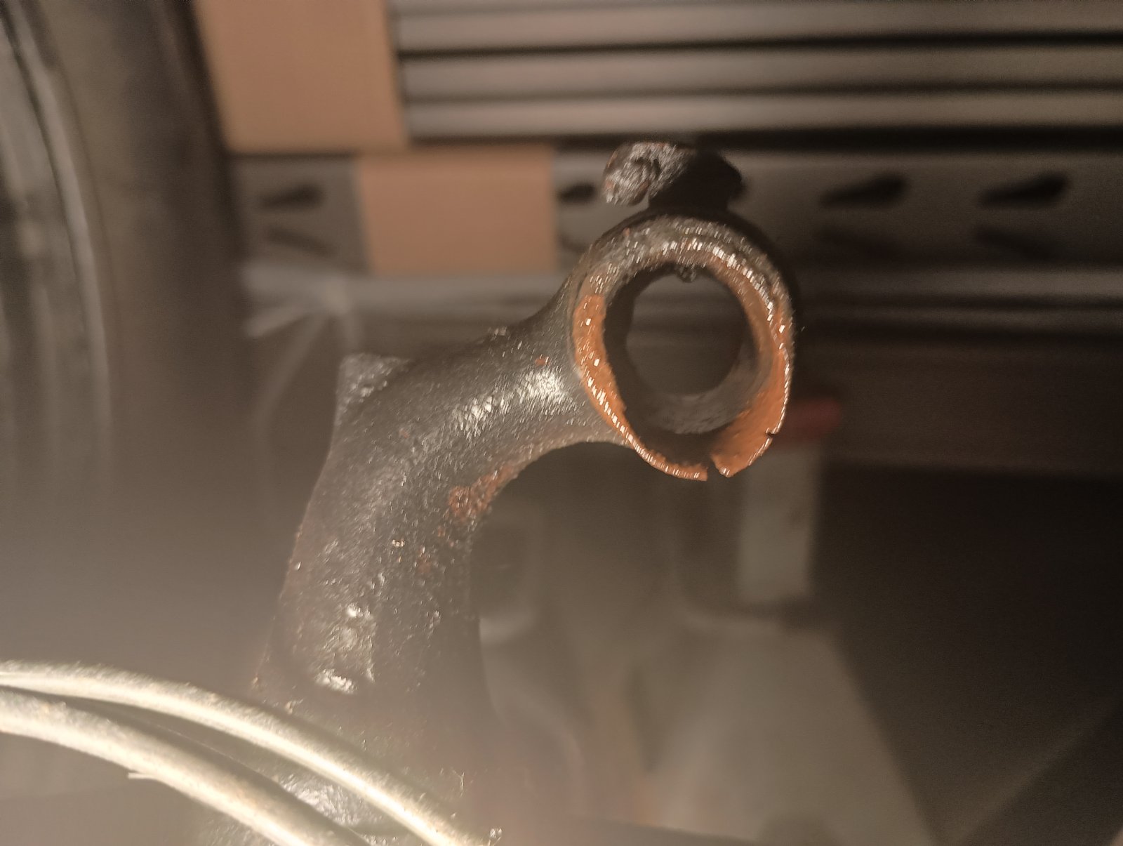

Wow. I can understand why she had the wobbles. The spring perch will have to be replaced. The shackle has worn through the bush and half way through the perch too. Getting the perches out of the axle can be a real problem, as they can rust in. Keep us in touch with your progress and help will be available
- Posts: 4703
Re: My new T
Wow! The spring perches need to be replaced! You’re on the right track to remove the front axle assembly and completely go through it. Rebush it all.
When Model T’s ended their days the chassis usually wound up on the farm and used as a trailer. Those homemade trailers really saw a lot of abuse and the frontends suffered the most. The perch you posted looks like what you would see on a worn out T trailer.
You will be surprised when you get your back together and how different it will be in driving and handling.
Good luck with your T and have fun driving it! And remember T’s don’t have real brakes like modern cars do but I’ll bet you already know it.

Here’s some information about spring perch installation. You may already be aware it can be a little tricky. Here’s an earlier post about getting them in correctly. There are lots or other posts about their removal also. They can be tough sometimes. Hope this helps. http://www.mtfca.com/discus/messages/82 ... 1546270034
It might be best to heat them up for removal. The heat wrench( Oxy/Acet ) works the best by the way!

I have it's twin #13648885, only 5410 units before. Just like yours the front end was all worn out, but it still drove well. Be sure to check the steering shaft and bushing fit at the steering box. It is probably heavily worn also. Plus, you may want to address the rear axle as well. Those old babbit thrust washers will fail soon after you start driving it. Trust me I have been there done that on 3 T's. It is much cheaper to address it before they fail and destroys more parts.

I bet the holes in axle yoke are as worn as the spring perches.
The bottom hole have threads in them.
Better check them out. Dan

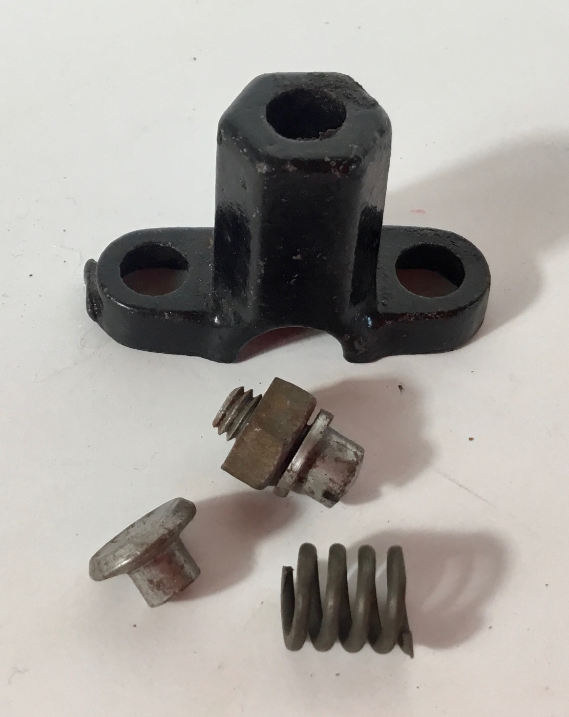

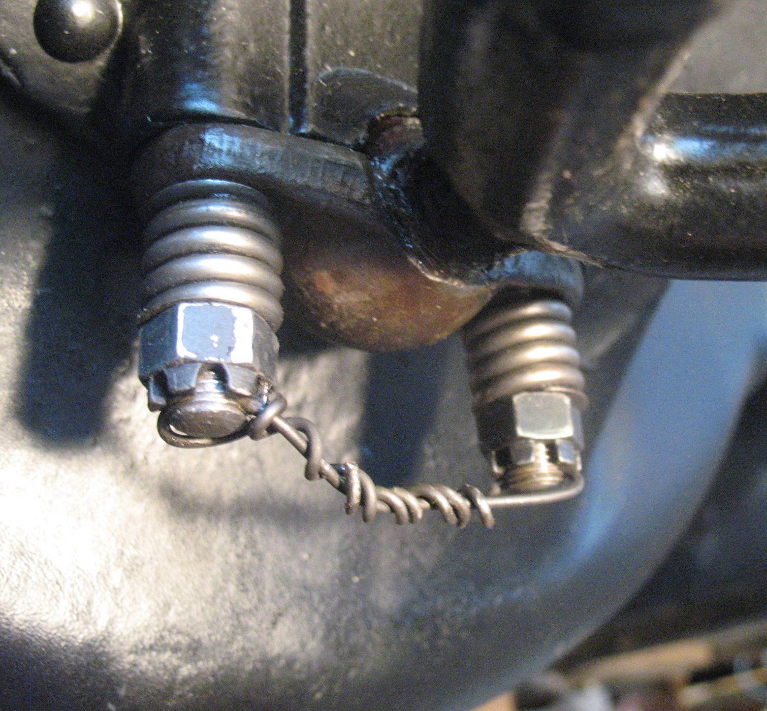

'One tip that is mentioned here from time to time here, is that when you install the wishbone ball cap, the studs must be safety wired together. Do not use cotter pins. The pins will keep the nuts on the studs, but they will not prevent the studs from unscrewing themselves.'
Now that is something I hadn't heard before! I think when the guy restored mine years ago he used cotter pins. Do you or someone have a picture of the wire method so I will know how to change that sometime?

That car looks pretty good overall. I'd guess someone just didn't oil the chassis often enough, or drove with the chassis dry and out of round tires.

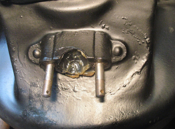

Pictures of the wish bone studs may help:

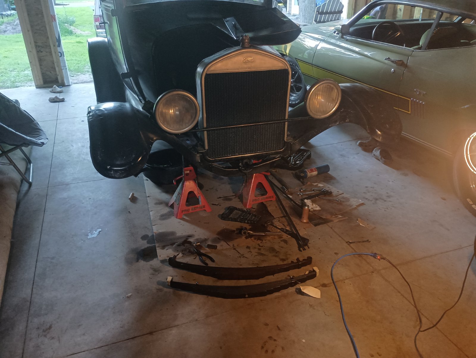

In the photos Steve posted, the springs are almost coilbound, ie compressed to the stage they have nothing more to give. The nuts should be wound on just enough for the wire to be installed. That way the spring is left slightly more relaxed, a.nd able to move with the flexing/twisting of the frame.

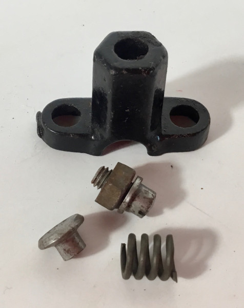

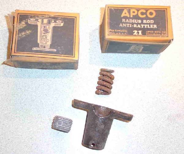

Spring loaded APCO ball caps are great for removing slop by applying constant pressure to the ball. I have found plenty of originals on eBay. There are 2 sizes for the Model T. Smaller ones for the front end and larger one for the wishbone ball. Jim Patrick

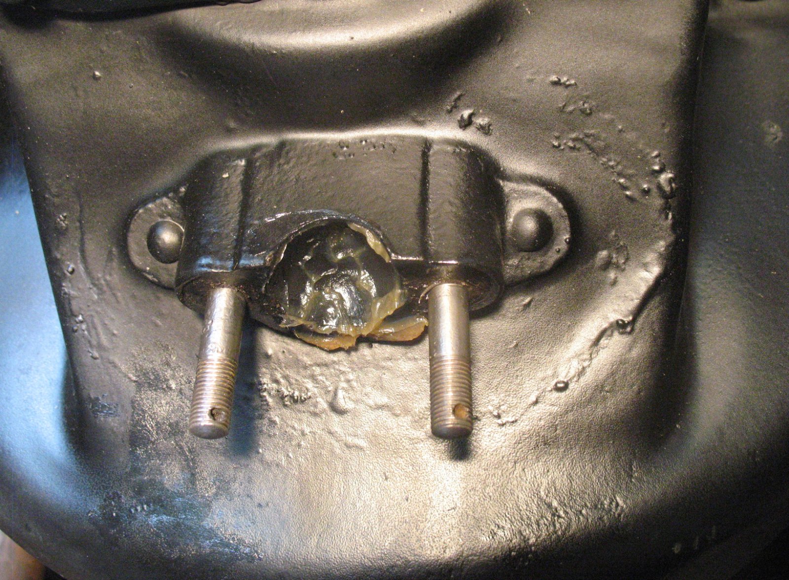

I had a little bit of time to work on it today. I got the spring perches half way out. I loosened them up by putting a braker bar through the hole and twisting them. And then beating them with a big hammer. They are rusted pretty good.
I do have one question. I is this wishbone ball still good. It looked a little out of round but not horrible. Just checking what you guys think.

The best check on worn balls and sockets for the wishbone is to fit the cap with no springs. If there is a rattle still, the ball/socket are well worn. You can buy new caps for the socket, and a shim in the socket may belp, but a built-up ball will be the real fix.
