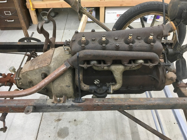

There is a multitude of extra holes in the side of the right frame member at the front. Did the frame have something extra added at some time?

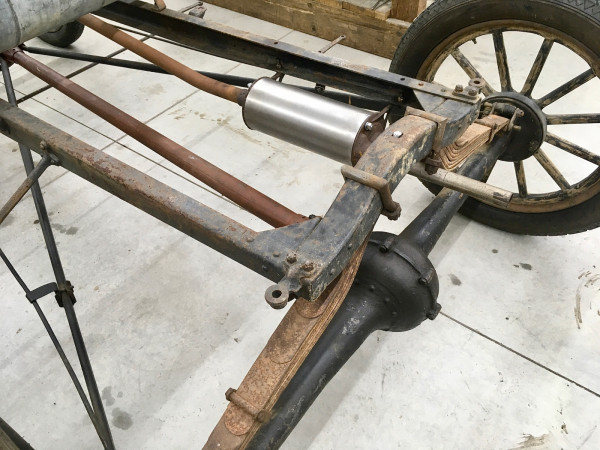

Looks like a 14 muffler.

It is Larry and one of your pipes too !

I don’t know the history of the 111 year old frame, but there are extra holes. Has a crack at the motor mount and had a plate welded over it that I removed. I haven’t been able to find the rear casting for a 11-14 muffler, but when I do I will correct that. My goal was to assemble a chassis, not restore it. It has been a fun challenge without the headache of serious money and untold hours of work. If I don’t do anything with it, it will be a good start for the next guy.

Tom - the "correct" - (depending on time frame) '13 muffler ends would have had 2 separate pressed steel mounts front & back rather than cast in the ends.

When I saw the extra holes either side of the pan mounting I thought that it may have had a riveted-in gusset to repair a break in the frame. Welding it in leaves the reason for the holes unexplained. What stories some of our T's might tell us.
