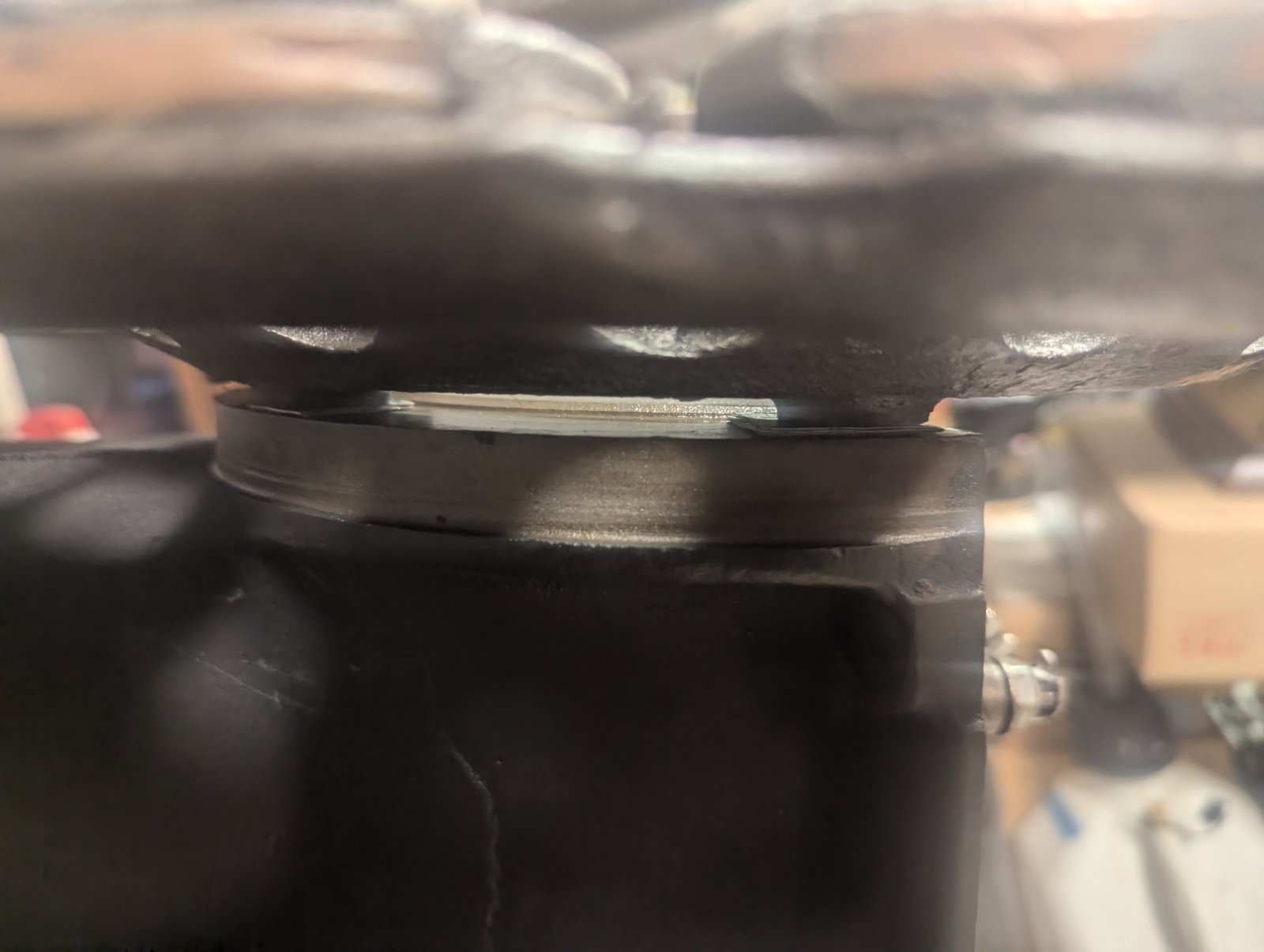

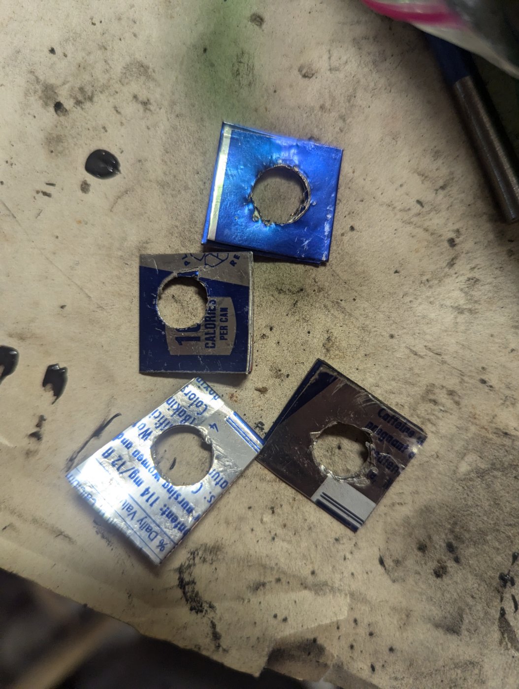

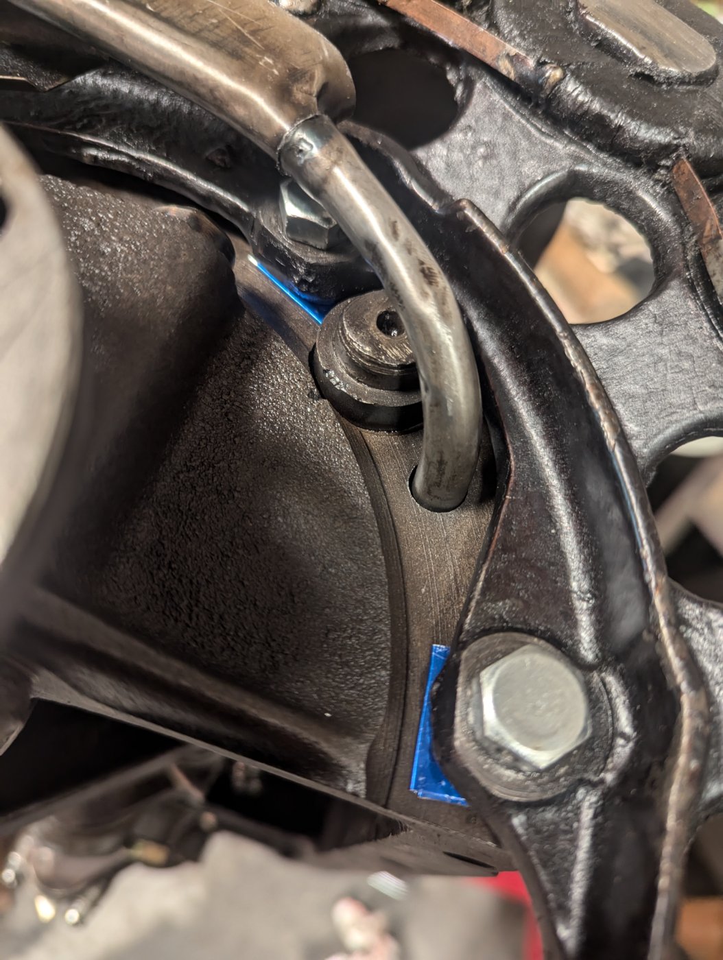

Thank you for the knowledge. I figured out my problem, should have posted pics cause you guys would have immediately seen my issue
I originally put the flywheel on so I could turn the motor over to adjust my new tappets, and that's when It jammed. I didn't take the motor apart originally, and I haven't seen one of these apart before. I ordered the green Ford transmission book and found out I was supposed to install the transmission shaft before the flywheel
Didn't think I had to read through that just to install the flywheel. I guess I learned a good lesson.
I put the shaft on and then the flywheel and had quite the opposite problem, I had about a 75 thousands clearance between the ring and magnets.
I cut up a redbull can I drank an hour earlier, and folded it over a few times. It happened to be exactly .040 thick when completely flat, so I made a few shims. It's got just barley more than .025 now (my feeler doesn't go bigger than that)
Thanks again for the help, I hope I'll see you at the Virginia City tour. I'll be the exited teenager in the 24 touring!

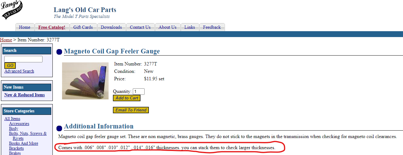

I assume you are using BRASS feeler gauges ??? Steel will give you an erroneous reading.
- Posts: 4394
- Posts: 5147
Re: Magneto jammed
The magnetizim creates a false friction, so you feel a friction like the gap is correct, but there is still a gap on the non magnetic side.
You can overcome this by adding more thickness (another leaf) feeling for the added friction of a correct reading.
The process is easier/more fool proof with brass feeler gauges.

I guess the RedBull can will work, but just so you know, the suppliers sell the proper shims for this. They have a small tab that is meant to stick up and act as "fingers" to hold the hogshead felt seal in place during assembly, so it can't slip back.Mr man wrote: ↑Wed Sep 04, 2024 11:00 pm
I cut up a redbull can I drank an hour earlier, and folded it over a few times. It happened to be exactly .040 thick when completely flat, so I made a few shims. It's got just barely more than .025 now (my feeler doesn't go bigger than that)
https://www.modeltford.com/item/3272BR.aspx
Your feeler gauge almost certainly goes past .025. You just need to put several leaves together, like .025 & .010 = .035". Or maybe your feeler gauge is not what I'm picturing.

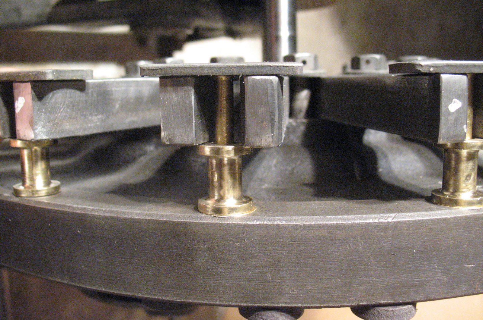

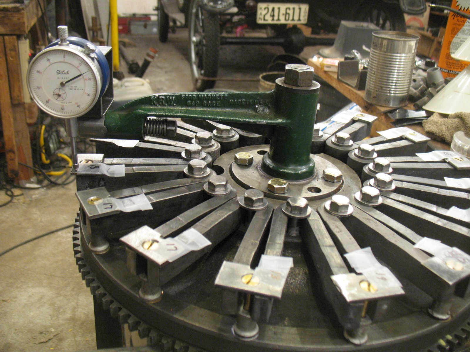

If somebody else has brought this up I missed it. When installing magnets on the flywheel you may find some of them "stick up too high" (closer to the mag ring). Some folks advocate evening them by pounding the high ones down with a hammer until they are all the same height. I find the idea of whacking fresh magnets with a hammer cringe-worthy. I would much rather avoid that by raising the low magnets enough to be even with the high ones. If I can get all of them within .003" I call it good.
I prefer making shims to raise the low magnets. I happen to have shim stock of .003" and .005" that can be combined if necessary. I don't recall ever having to use more than two shims to get all the magnets to a uniform height (within .003").
You can see shims under the spacers to get all the magnets at a uniform height.
Checking magnets for uniform height.

I can agree with Steve re pounding on the magnets to adjust the height of the retainers, but with a different reason. I will always use a set of new, machined alloy spacers. The originals are cast, some are cracked when you take them off, and more will likely crack if they are pounded on.
Using a nylon faced hammer to make a height adjustment on a new alloy spacer is OK by me, but only if .002 - .003" is required. The last one I did needed shims to bring two keepers up to the height of the rest.

I start assembly by measuring magnets, keepers & spools. Shuffle accordingly & add brass shims to the spools like Mr Jelf does.
The few that may be a few thousands off, (higher) get squeezed down to size in a press. No hammering.
