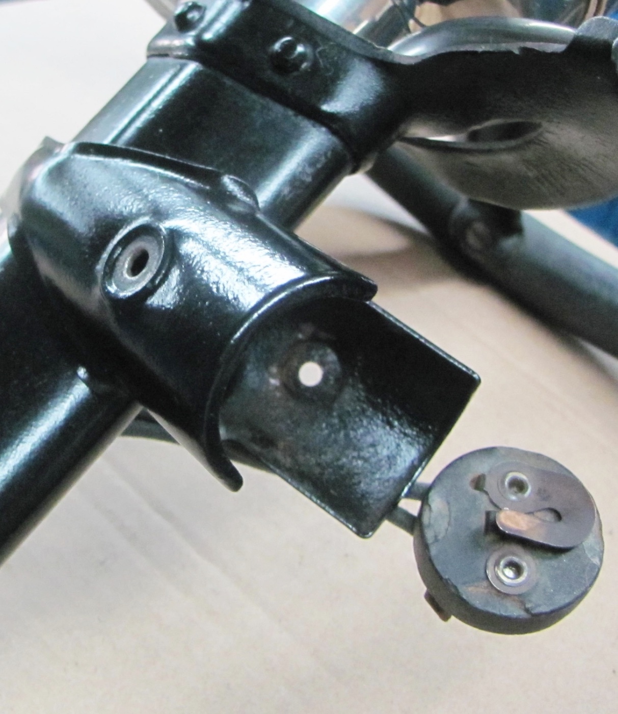

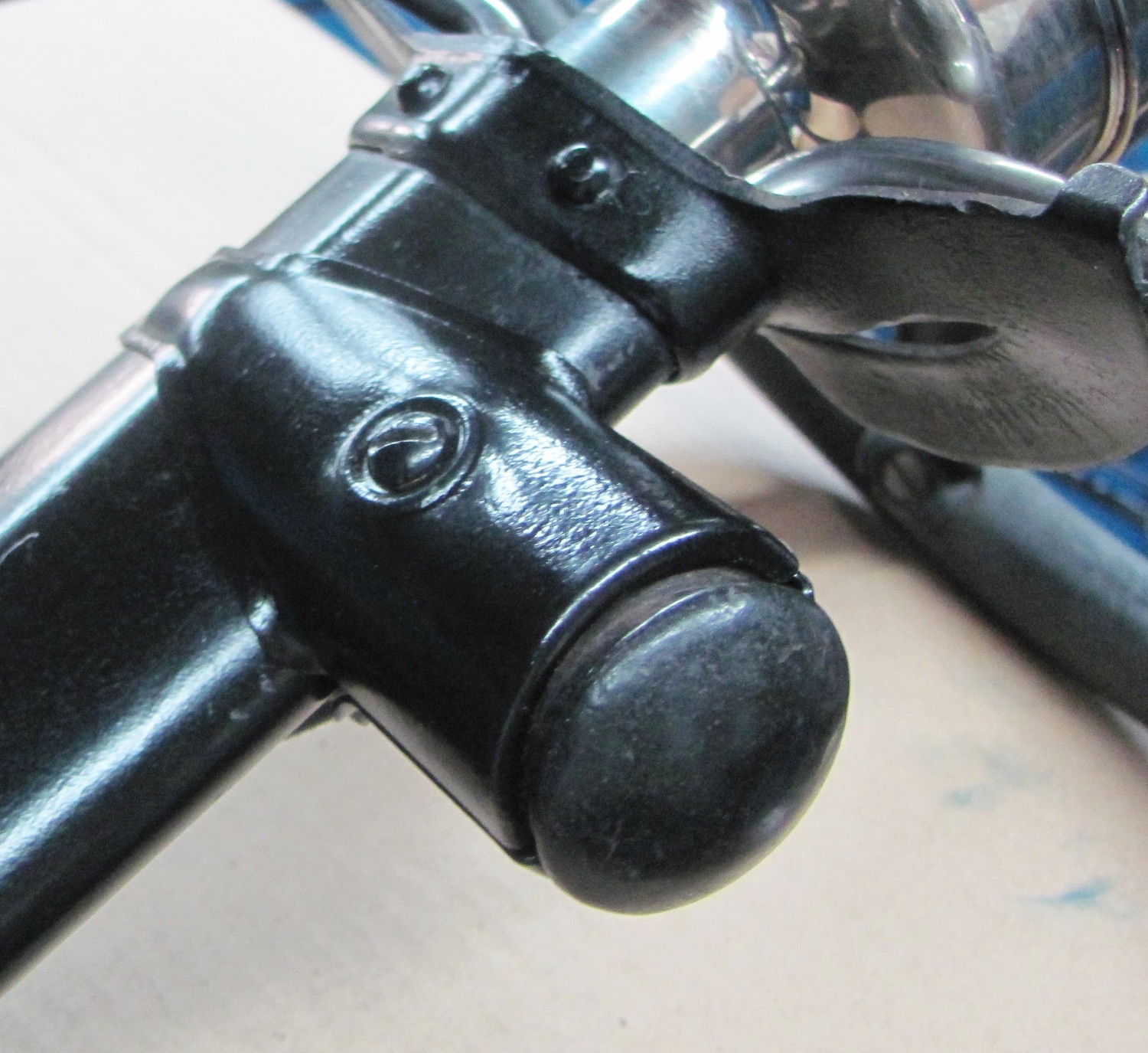

Even a poor horn switch can be repaired. Best to use new wires, stranded and tin first with solder to make the hook to fit the little screws, or replace with new ones. About the only thing that happens to the bakelite button is the nub inside that pushes on the ribbon contact can wear down. Have replaced that nub with head of an upholstery tack anchored in epoxy. The ribbon contact should be cleaned and springy to provide the electrical needs. Mount carefully and the switch will be like new again.
A tiny drift pin helps align the two lugs on the underside of the Bakelite contact part to pass the bolt thru, as you hold the bracket and button in place.
