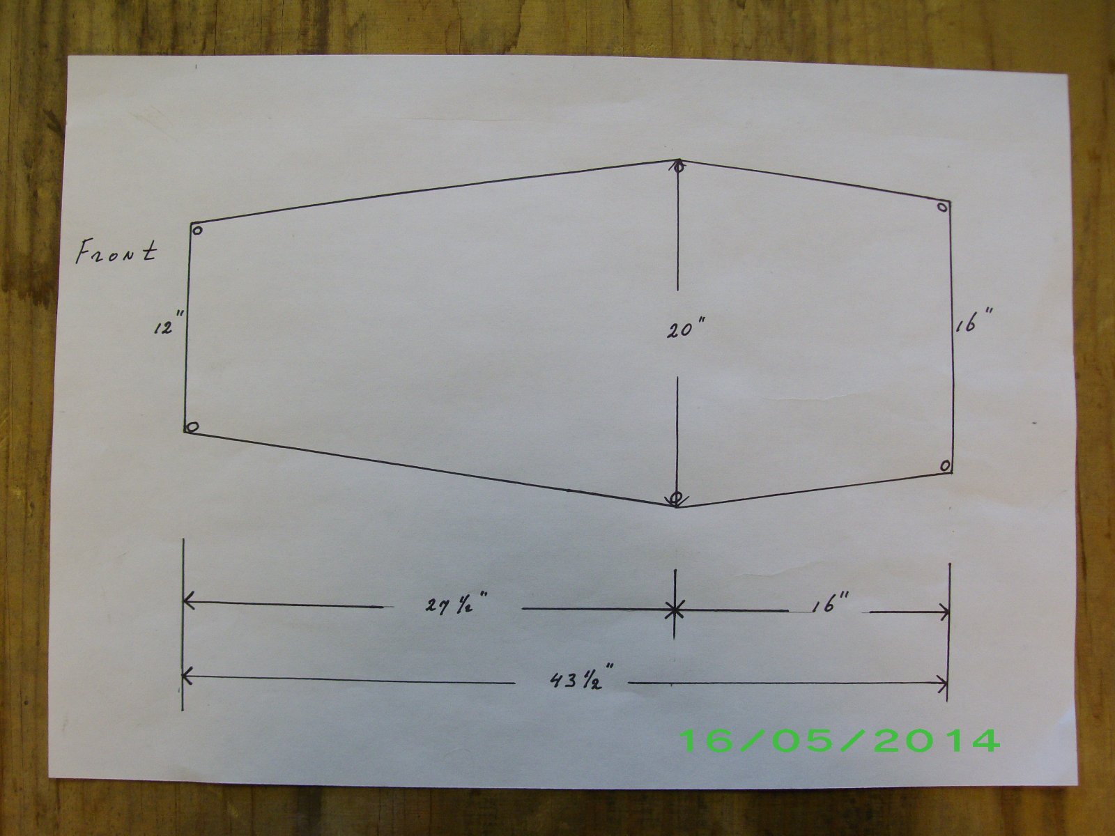

For that oil leak , I use a ]DIAPER ] see pictures .
