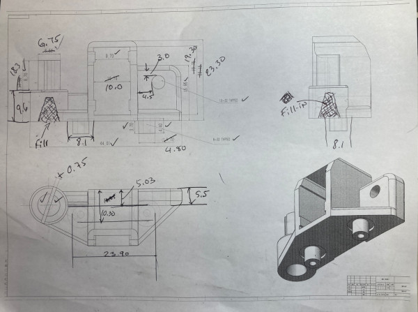

My first goal is to reproduce all parts necessary to rebuild starter & generator brush holders with ALL NEW components at the highest quality possible. 10 months later and I'm almost done with this first phase. I had no idea at the time just how much work it would take to accomplish this goal. But I persevered and overcame all the obstacles, and there were many. I'm an accomplished engineer and am no stranger to creating engineering drawings and product specifications.
Those are one thing. Getting specialized vendors to produce high-quality, usable parts from them is another thing entirely, sometimes having to start from scratch with a new fabricator. It's not sexy stuff. In fact you can't even see the parts I'm producing for your car. But all cars produced from 1919 to 1927 (and many others) need these parts to keep running, both now and in the future. Somebody had to do it. I'm doing it....

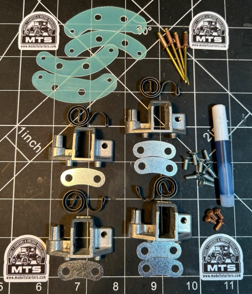

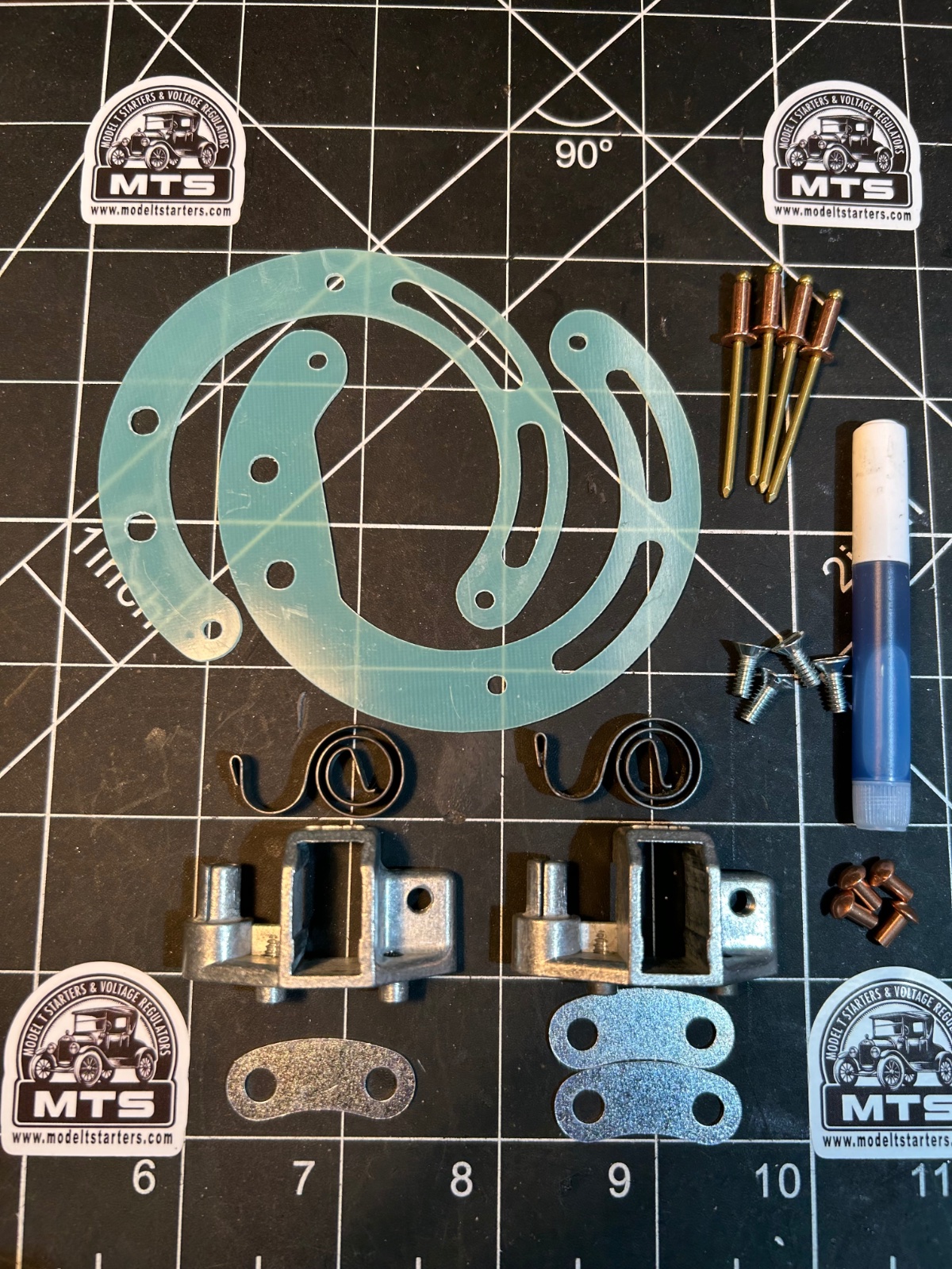

Im creating rebuild kits to refurbish starters and generators with all new parts. Everything needed to rebuild these units. I even sourced 2ml vials of Loctite (have you looked at your dried up Loctite bottle lately?)
  • Brush holders molded and die cast from Zinc (not pot metal as was done in the originals)
  • Brush plate insulators laser cut from FRP that fit perfectly and are 1/32" thick
  • Brush holder backing plates laser cut 1/32" thick
  • Brush holder springs of the correct tension perfectly molded & shaped for both starters & generators
  • All the correct hardware necessary for the rebuild - rivets, screws, Loctite etc

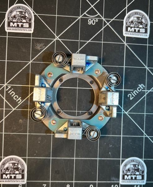

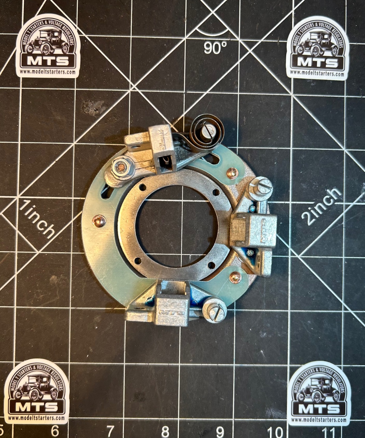

Once implemented, these components produce these completed brush holders - again with ALL brand new parts:
Using the parts I fabricated and starting with a blank starter brush plate it took me all of 10 minutes to fully assemble what you see in the picture above. Anyone whose done this before knows it normally takes a few hours of work to clean & massage all the used parts into a useable rebuild.

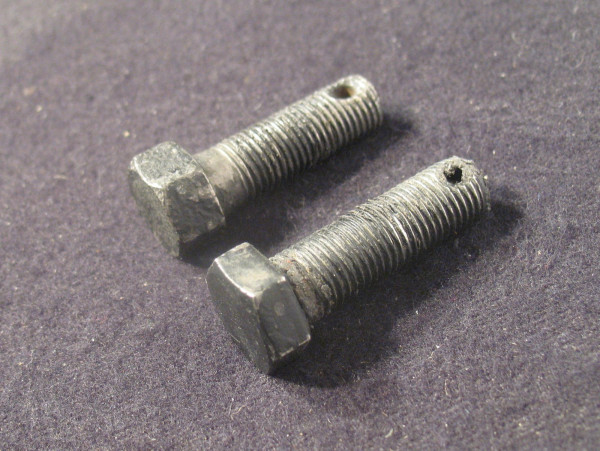

Nuts & bolts. You can buy the modern ones at a hardware store, grind off the markings, drill cotter pin holes, and get something similar that show judges won't notice. But compare an original bolt used by Ford and an adapted modern substitute. The difference is obvious. As far as I know, there is nobody reproducing the originals. Most of us don't even recognize the difference, but once you do it's hard to miss.

No offense Steve..... but I personally have zero interest in reproduction bolts and some judge's esoteric opinions on said topic, but I do care about being able to reliably start your car and actually drive it without breaking down too often! These cars were meant to be driven.

As to Steve's comment about bolts - If my goal was a 100 point Pebble Beach car I would agree with him. That is not my goal, and as long as the bolt head is square where it is supposed to be square, and no Philips screws, close enough.

I think Steve should have a look at the bolts Lang's is selling. I've been buying up originals for years, and was even able to build a car from scratch using all the correct nuts and bolts. It's always been important to me to do this.

I don’t think Steve was saying that making exact reproductions of nuts, bolt and other fasteners is a have to do for a Model T. Steve is right to give advice about how to fabricate modern bolts that closely look like the originals. I’ve done that as well as others to complete a car. Exact duplicate fasteners aren’t necessary for a good running car like a generator and starter is. For me an original generator and starter is more important than a fastner but that’s just me.
