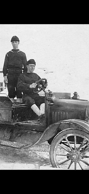

Hey all,
I am building a 1917 Great war no brass car.
There for I am looking for the 1917 hood shoulders.
Are there some where available? Even used will be Ok.
Or are there photos or drawings available to build them myself?
Andre
