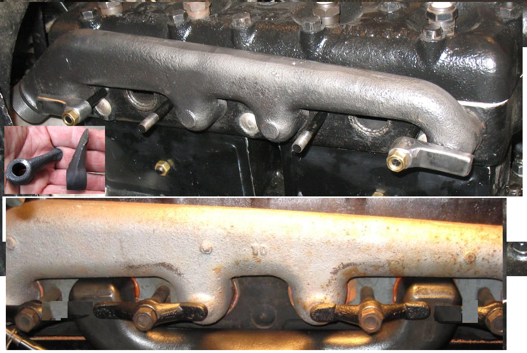

Didn't have pictures so I borrowed some from the internet & modified
Once you have the rings in place into the block with the copper rings around them - setting the exhaust & intake manifolds can be made easy by making a simple tool. Cut off one ear of each of to manifold clamps. Set the exhaust manifold in place and hold them there with the clamps in the outer positions. Then place the intake manifold in place and use the regular clamps in the inner positions to hold both manifolds. Replace the short clamps with the full ones. Done
I made a pair of installation clamps because I dislike the idea of cutting up original parts.
