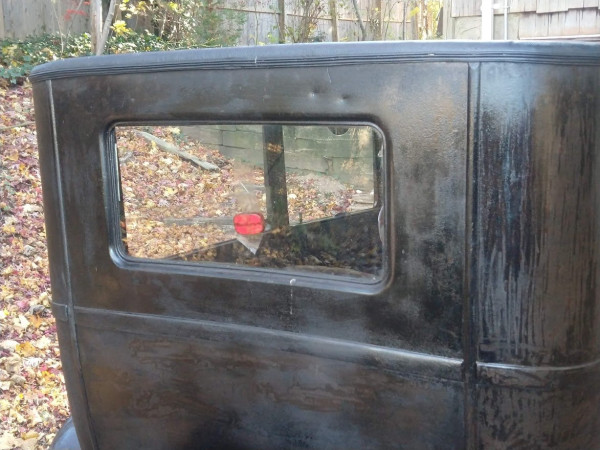

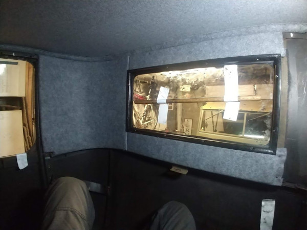

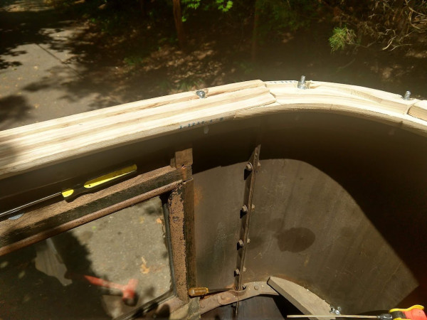

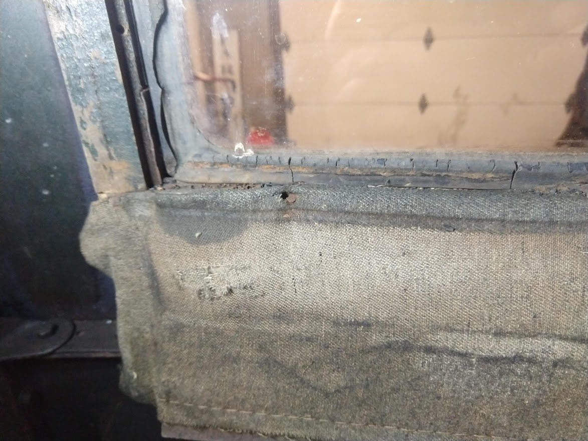

Here are the photos I took as I restored my rear window. Rubber u channel holds the glass in place, and the metal frame holds the rubber to the body:
Before: During: during: during: final:
