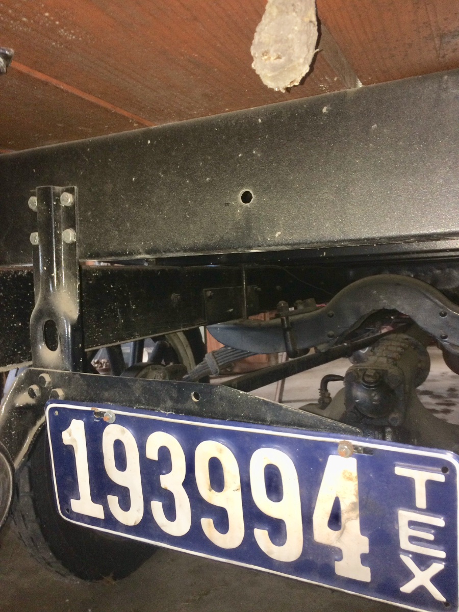

Thank you George. When you have time would you mind posting a photo of how the bed is supported underneath?
Ralph
Ralph
- Posts: 3021
- Last Name: House
Re: Need TT bed info

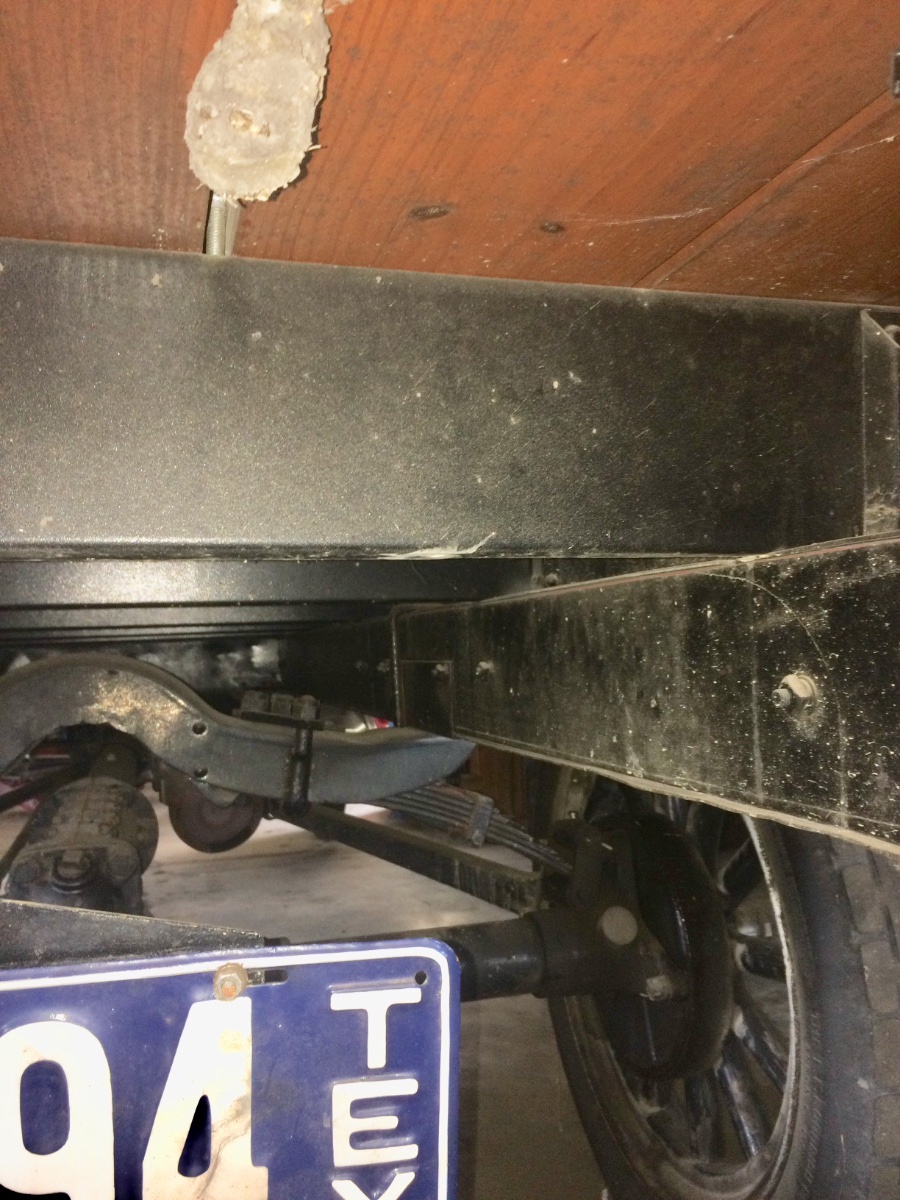

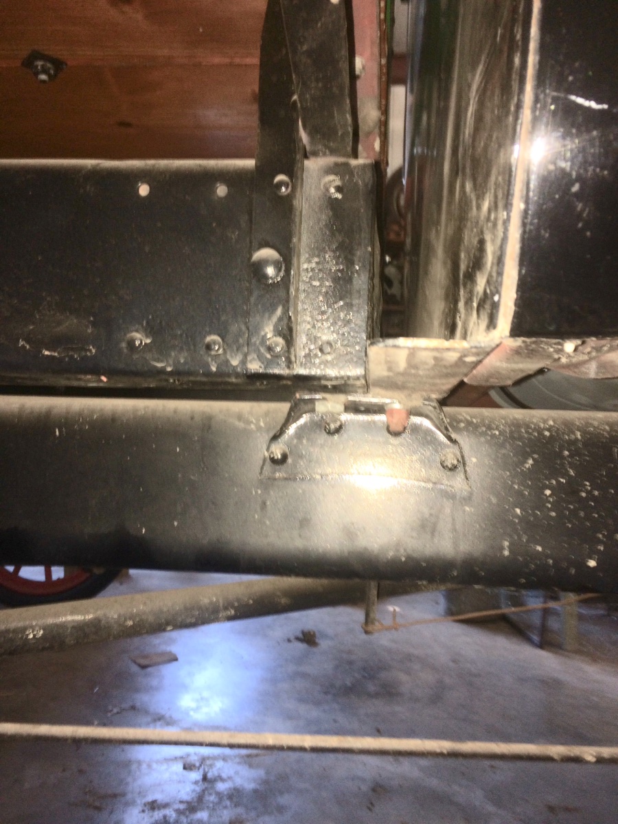

Sure....The TT stakebed is metal and wood. I have an example of the bed wood and it is Pine. Underneath the bed, in a metal subframe parallel to the truck frame, there is installed a hard wood. I used oak. See the pics. The subframe rests on the ‘ears’ of the rear frame crossmember and, in latter years of TT production, is fastened by U bolts. The taillamp/license plate bracket is fastened to a rear cross-bed metal support. I’m sorry about the muddauber nest at the top of the pictures. They’re our state bird and we’re not allowed to disturb their nests...
- Posts: 3021
- Last Name: House
Oh, .... and please enlarge the pictures to notice the heavy gauge sheetmetal ‘channel’ that wraps on each side and bottom of the bed subframe where it contacts the frame crossmember ‘ears’. It is encompassed by the U bolts. Later frame ears like mine have 2 holes in the crossmember ears for the U bolts. Earlier TT frame ears have only 1 hole. Which is yours Ralph ?

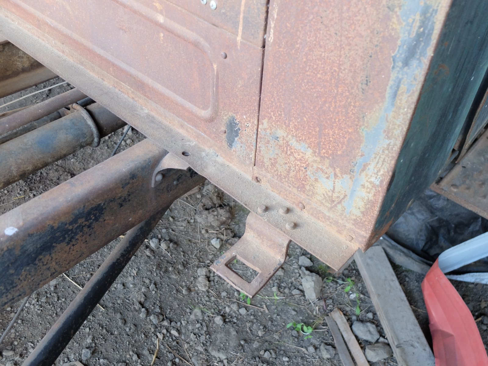

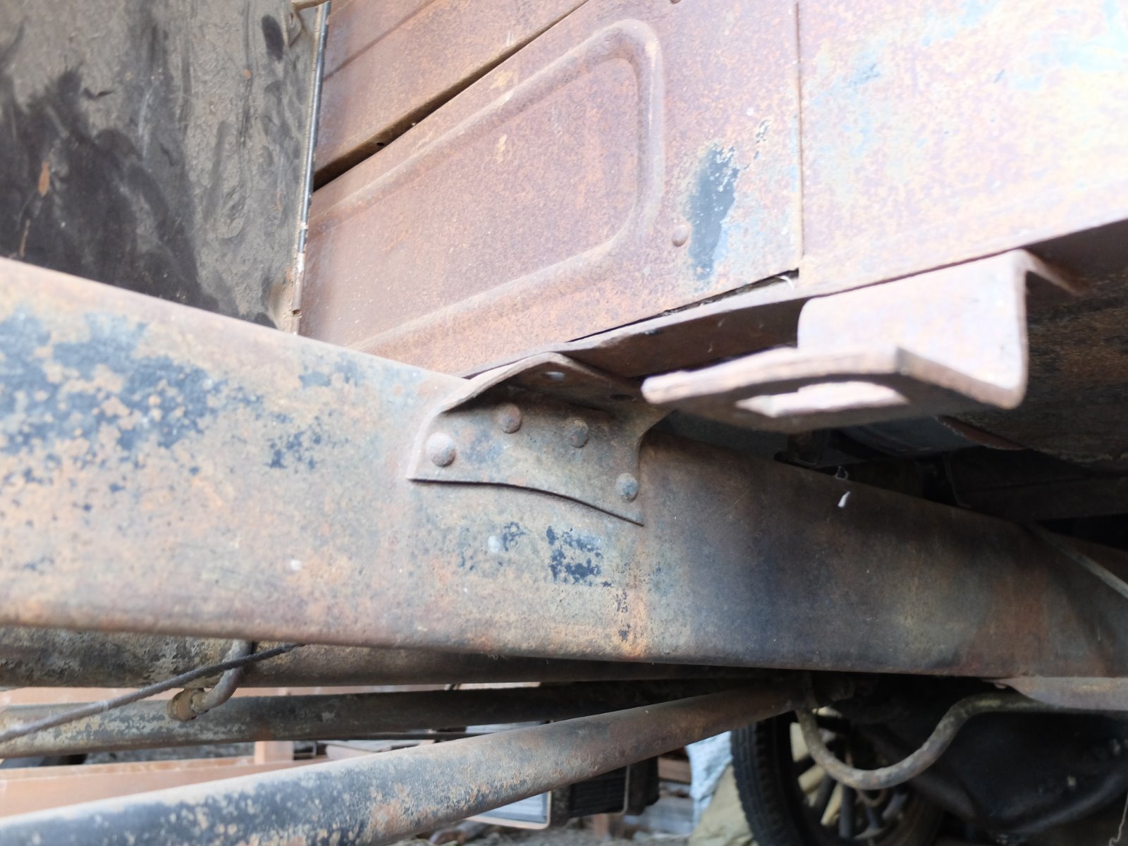

Well, now I got my old butt on the creeper and rolled under the C Cab. Understand that only 5 % of TTs were sold with Ford Cabs - either C Cab or Enclosed Cabs. They’ll have the frame-to-body brackets like my attached picture. However, if you have the car body-to-frame brackets, yours was one of the 95 % that was sold as a chassis to have made locally a custom wood cab. There are two peculiar and different brackets. A metal working fabricator could probably reproduce these. All 3 pictures taken from the right side.The first 2 pictures are of the rear bracket. The red oxide painted bolt/nut fastens the body. The other fastens the bed. The last pic is the front bracket from below. If you don’t have a Ford Cab; all you need is the car body-to-frame brackets. Good luck

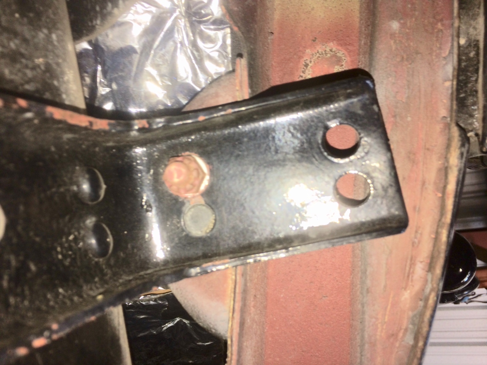

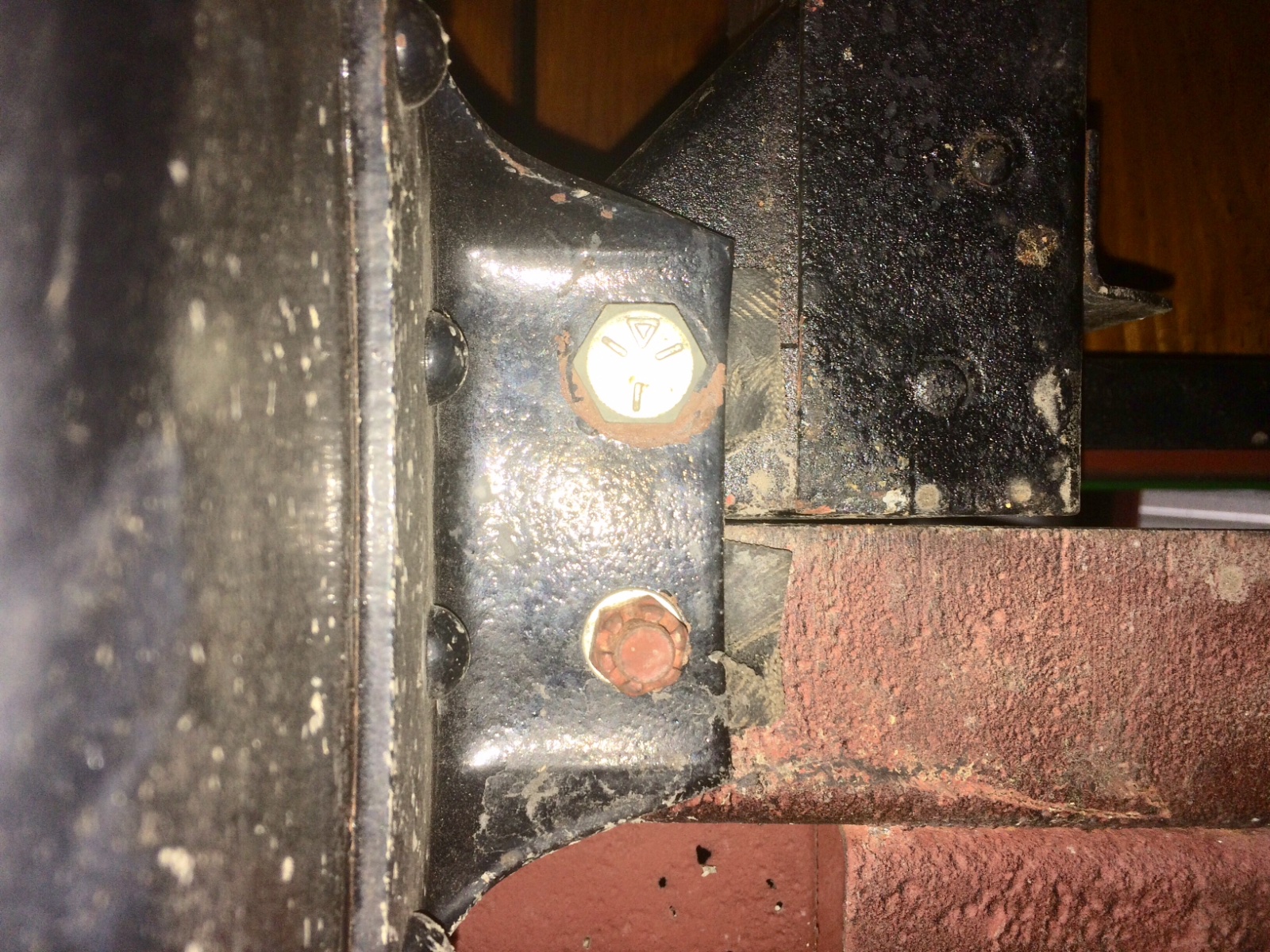

George, mine is a factory closed cab truck. It has the same bracket at the back of the body as yours, but only uses the rear hole for the body and whatever bracket for the bed there was. This tells me that the C cab must have been slightly shorter since it used the front hole. The pics below show my bracket from below and above. Any idea what the second bracket you see in the second picture was for?
Ralph

Ralph, I sure don’t know what that offset bracket w/ 3 rivets and rectangular opening ....is for. Have had 3 Enclosed Cab TTs and never saw that.
