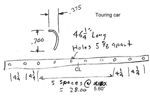

The 15 has a steel round that fastens the rear of the top to the body. Anybody have an idea as to where to source the material?

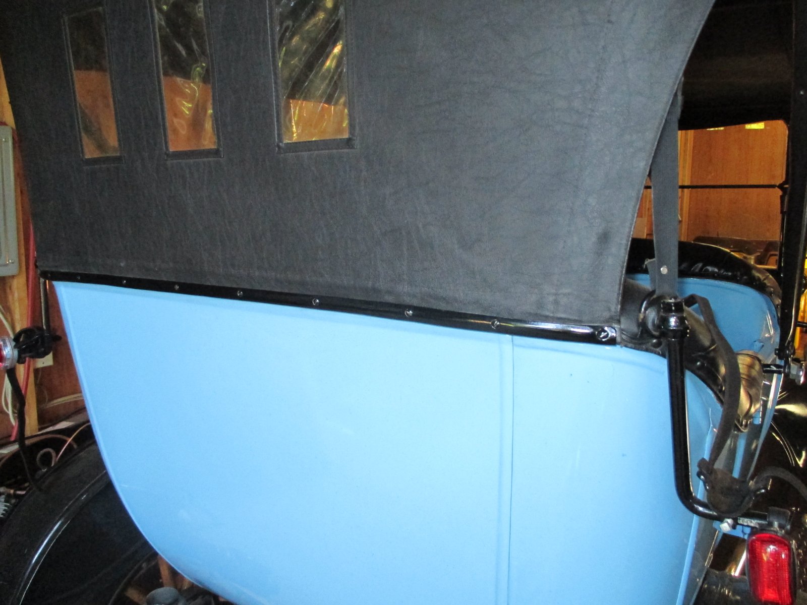

Is this what you are looking for?
Compound curves are tricky...
Touring or runabout?

Post by Kbillet » Fri Dec 06, 2024 5:14 pm
1915 Touring

Post by jsaylor » Sat Dec 07, 2024 12:21 pm
See a possible product on this speedster site. https://www.facebook.com/groups/496619540483459. Scroll to James Starkey post.
Taco Marine and Restoration Supply.

Post by Kbillet » Sun Dec 08, 2024 9:42 pm
Thank you Jsaylor. It looks like a likely solution

Post by Allan » Sun Dec 08, 2024 10:10 pm
In the meantime, you could use a length of trim strip and upholstery nails. Hidem binding is a bit late to be using on an early car.
