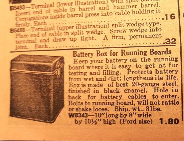

Re: Battery Box on 1914 Touring
This is from a Western Auto Catalog.
- Posts: 4523
In the last photo of an after market battery box it shows the weight to be 81 lbs! Maybe I read it wrong but is that including the battery too? If it shown to be 81 lbs. that has to be a misprint.
To me the box would about 20 lbs at the most. If you wanted to mount the battery in a battery box you could use a period correct running board tool box that’s about 10” x 16” or thereabouts. It’s a good probability owners did that or something similiar.
Shipping wt 8 lbs.

- Posts: 4523
Thanks for clearing up the battery box weight big2bird! Didn’t catch the detail because it’s run together. That sounds about right for the weight since I have a running board box similar to that and it’s close to 8-10 lbs.

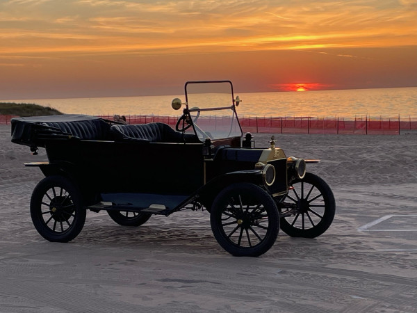

Also...my office is right next to Lake Michigan. I stopped on my way home from work and took this picture about 7 weeks ago. Isn't cruising the beach after work better than going to some show and sitting for hours? Maybe I don't need to worry about keeping it strictly original.
