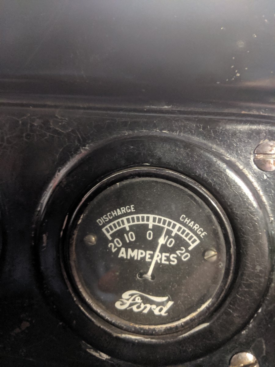

Hot damn!! That worked!John kuehn wrote: ↑Fri Jun 21, 2019 1:55 pmDoes the generator have the cover still on it on the brush end? If it does take it off and do a visual check to see if the armateur is dark or not very brite. It may be dirty enough to cause the generator not to charge. And if it does it would intermittent at best. Clean up the armateur using WD-40 on a rag and clean it up the best you can by using your finger with the WD40 soaked rag. With the engine off of course! Rotate the engine to do the other side of the armateur.
Any older engines that have a generator with brushes and after lots of use do get dirty and Model T’s are no different. Old tractors do the same thing about intermittent charging. Simply cleaning them can make a difference.
Pic is the ammeter at low idle.
Thanks a ton!
