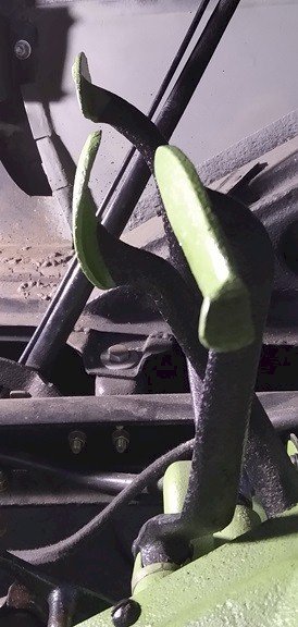

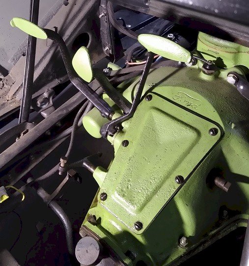

It's more stuck than anything. I replaced the three pedal return springs and tested the brakes (stopped the wheels from turning) but it stayed.
1) Pedal is wedged against the hogshead.
2) Back and forth play in the pedal.
3) Gap in the brake pedal.
So, how to fix?

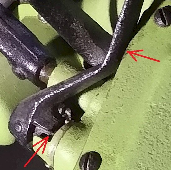

Here is a close up to show that the pedal does push left a bit and that it hits the hogshead.

The pedal motion to the left appears to be fairly minimal, given that the pedal is now fully depressed. If you had more travel to the left, your pedal wouldn't hit the hogshead so soon. It makes your pedal cam & pedal* suspect for too much wear.

So, I pulled it and took more photos.
Brake pedal does not pull back in position as much as the other two pedals.

I had found a similar situation when I rebuilt one of my hogsheads. The brake pedal was rubbing against the side of the hogshead and was easily remedied by bending it to the left.
I used a large crescent wrench to grab the peddle on top by the foot rest. It’s smarter to use two wrenches as discussed in Dan T’s post here:
https://mtfca.com/phpBB3/viewtopic.php?t=27309
If you still have it pulled, you could straighten it in a vise.

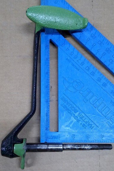

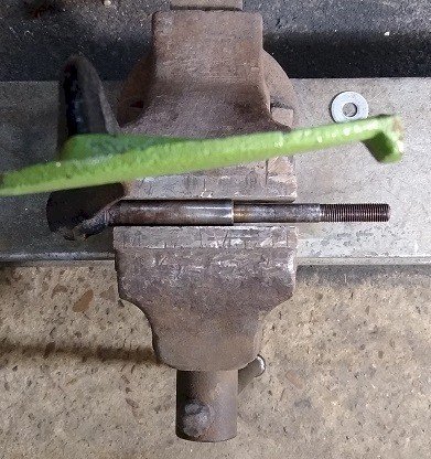

Your first photo, looking straight at the pedals, makes it appear that your brake pedal is bent somewhat to the right. Bending it to the left, and checking that it still fits in the floorboard pedal slot, may help you a bunch.
As for the brake cam, I would buy a new one and at the very least, use it as a gauge to determine what wear you may have in your current cam & pedal. If you confirm wear, you can use the new cam and weld & trim the mating pedal cam to match.

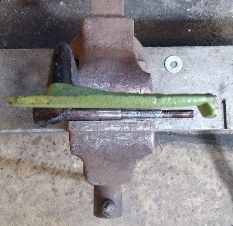

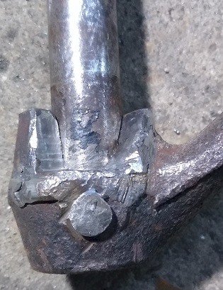

Yes, it is still out of the transmission. I removed some paint for the torch, before twisting the pedal and bending the shank back to the left.
brake 11.jpg (59.82 KiB) Viewed 5554 times
brake 12.jpg (66.89 KiB) Viewed 5554 times

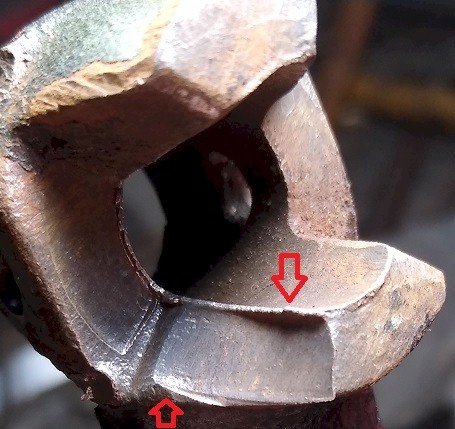

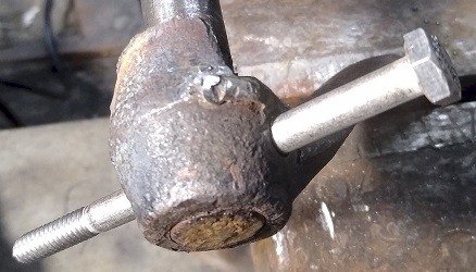

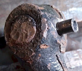

That hole in the 1/4" pin is there because I drilled it.
brake 14.jpg (38.98 KiB) Viewed 5554 times

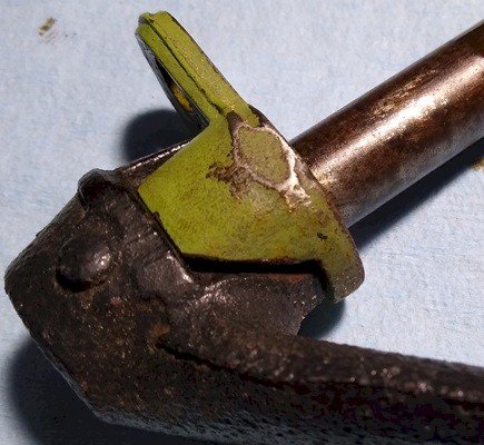

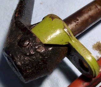

I found green paint in the center of the cam's contact, indicating a lack of wear, probably because somebody has already replaced it.
brake 13.jpg (37.21 KiB) Viewed 5554 times

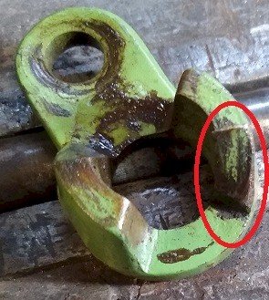

The pedal, however, has worn so much that it has ridges.
brake 15.jpg (54.75 KiB) Viewed 5554 times

The green paint on the ramp may be there simply because it has not been making contact with the wear surface on the pedal. It could still be worn. It is cheap insurance to replace it with a new one while you have it torn down.
The ramp on the pedal will need to be rebuilt with weld, and hand worked back to a good fit with the ramp. That wear surface is a spiral rather than a straight ramp. When dressing it back you will need some blue. Both sides of the pedal ramp need to be worked on until each makes good contact with the ramp surface. When you have finished there should be very little pedal motion before it begins to ramp up.
Once you have that sorted, then you can bend the pedal arm back to align it with the others.
Hope this helps.

From experience a spring roll pin will shear…, use a solid metal round stock and pen the ends.
Just Sayin’

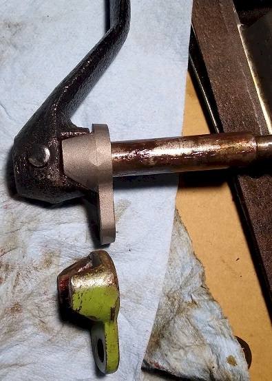

brake 20.jpg (59.95 KiB) Viewed 4542 times
The new cam arrived and I removed the brake pedal again but the new part has about 1/64" play whereas the one I built up has none. So, the cam that came with the coupe is back on it and all it sorted out with the brake band for now. The new part will go into my spare parts tool box.
