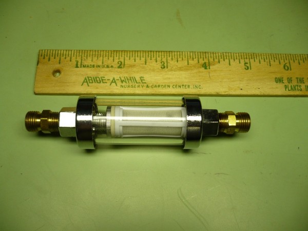

I believe this is the filter recommended by Stan Howe. It came from MODEL A GARAGE in Luray Va.
I have one on my 26 tudor with a U&J carb and my son has one on his 26 roadster with a Model B carb and both cars run great with no fuel delivery problems.

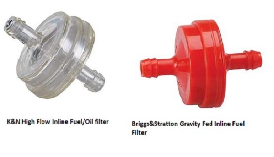

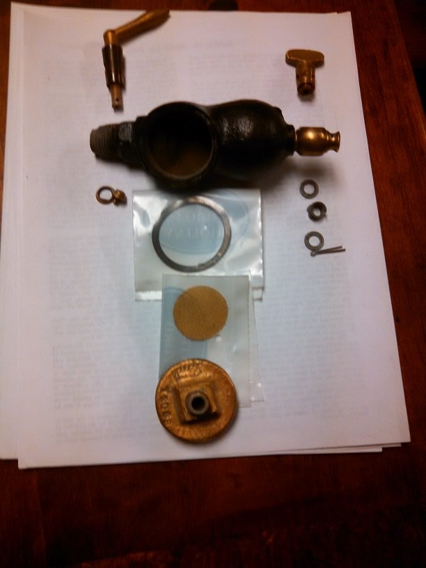

I have been looking at replacing the Sediment Bulb with a Ball Valve/Filter and in the process I have gained some insight into the functions of the Sediment Bulb and some possible component replacements. Having said that, I also found some filters that look okay but further investigation nixed them. But first a review of the sediment bulb - which includes a brass mesh screen, i.e. filter, to block dirt, rust etc. Since the fuel line is above the bulbous portion, the bottom of the sediment bulb likely was intended to capture things heavier than the gasoline, chunks of rust, dirt and WATER (yes water). I have looked at various filters, some designed for gravity flow, others are intended to operate with a fuel pump and others that do about the same thing as the brass filter in the sediment bulb. The picture of the two inline filters: a K&N which is similar to the brass filter, is for high performance engines so fuel flow should be unrestricted. The Briggs filter pictured is for small horsepower lawn & garden engines - they have an identical looking one for engines with fuel pumps - (neither should be used). Now the only reason why I was looking to replace the Sediment Bulb was because of the valve design not the filtering. Today's gasoline is much cleaner than that it was back then, if it gets contaminated its likely water contamination. Bottom line - keep the sediment bulb, if it leaks buy some EZ-Lube to set the valve, if that doesn't work buy another one. I haven't found a method to take care of water contamination.

The one pictured first by DLMYERS is what I use on my Torpedo and believe it would work well on an underseat tank. Someone posted about a '26 which has a lot of head pressure compared to yours. It's a worth a try and very easy to see and take apart to clean anything that accumulates there. I got mine from Auto Zone.
