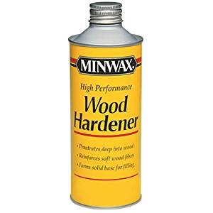

- Posts: 6590
Re: undercoat/sealer
I have used MINWAX Wood Hardner on spokes and other wood surfaces. There are similar products on the market too. Its consistency is so thin that l doubt if it could be applied upside down. The add says deep into the wood, I'd say 1/4" and it gives the wood a rich tone. I apply it generously and capture the run off, let it dry, sand, apply a another coat and sand again. The coating before sanding feels plastic like, after sanding its feels and looks varnished. Try it you'll like it. May be great for coil box wood too.
