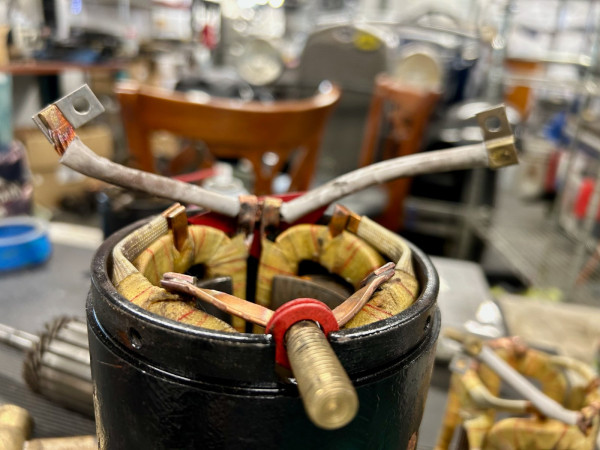

Firsts off, this is NOT an ad for parts for sale. Like everyone else I've been holed up inside all winter, and I've been busy. Some folks work on their cars, I've been busy making Model T parts and I'm finally starting to see the fruits of the literally hundreds of hours I've put into engineering and fabricating EVERYTHING inside both Model T starters & generators, one painstaking part at a time. I just got samples of the brush plates in the mail today and they look fantastic!
One way or another I'm going to get the cost of a new starter or generator to drop like a rock. Wilson field coils are now over $100. Its crazy. I'm putting an end to the craziness. My goal is to bring the cost of both starters and generators with ALL NEW COMPONENTS to under $300.
Also, a lot of these components are just not salvageable from cores any longer, they're just plain worn out.

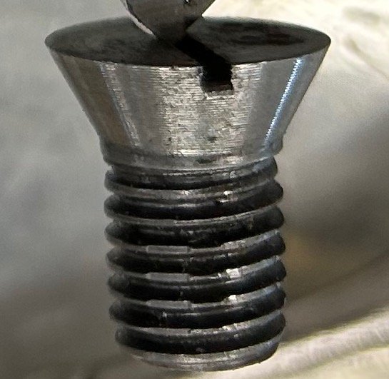

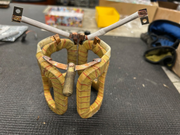

I'm now making both starter & gen field coils, brushes, springs, post bolts, brush holders, brush plates, everything. Starter Field coils will have the copper (not brass) post silver soldered & pre-installed. Initial testing by myself and others shows them to be equivalent and in some ways vastly superior to the Wilson coils we're currently stuck with using. If you can even find one.

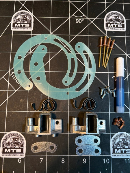

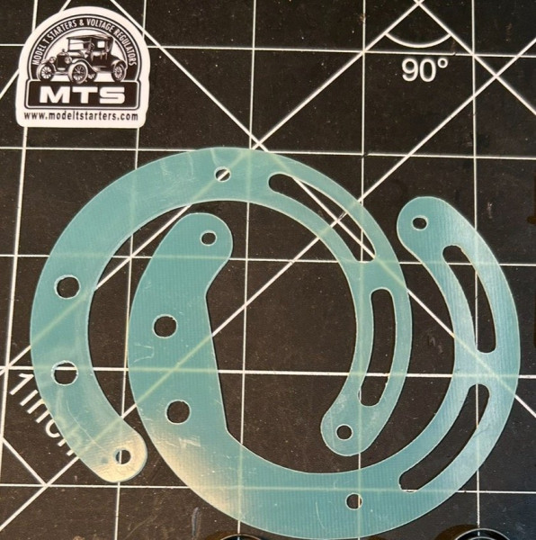

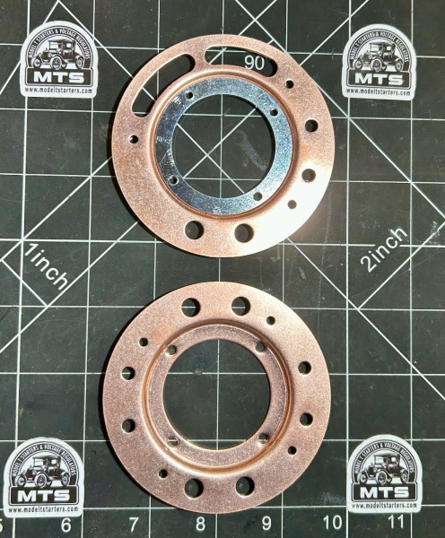

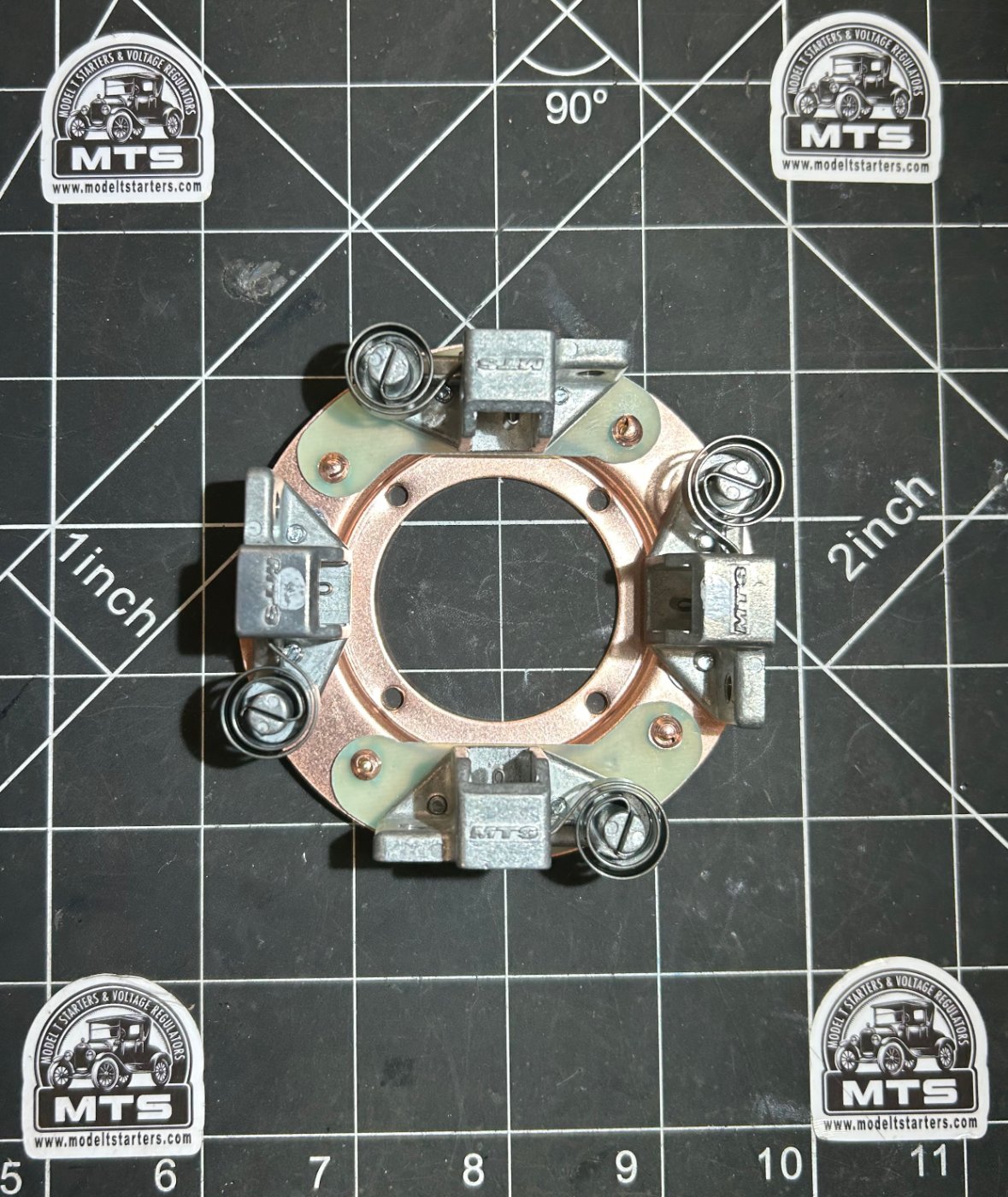

I'm also reproducing both brush plates and adjustment rings - they came out great. I also had them copper plated for superior conductivity. You gotta get as much of that energy from the battery to the starter as possible.

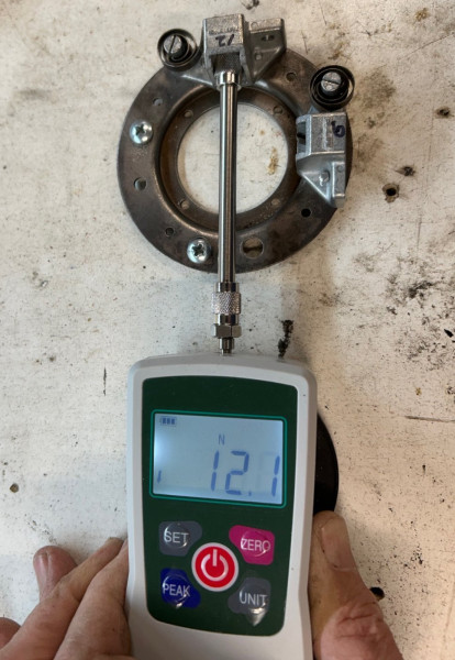

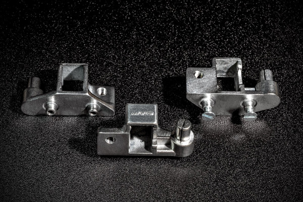

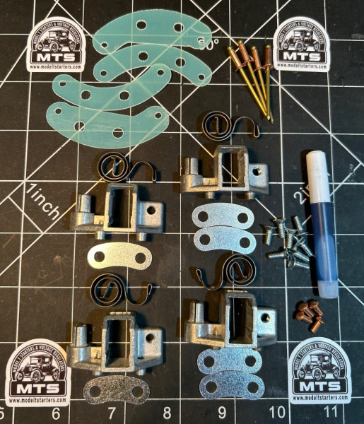

Zinc cast brush holders w/ reinforced screw receiver & pre tapped & drilled posts I'm also putting kits together that contain everything needed to do full rebuilds Did you know that starter springs have twice the force as the generator spring? 12 Newtons vs 6 Newtons. With any luck, I'll have all this stuff done by early May, coming to a vendor near you.
I'm working on Generator armatures next - it's almost $200 to get them rewound (it used to be $45 not that long ago). Mine will be brand new and be less than half that.
This hobby needs to remain affordable. So, I'm doing my part!
