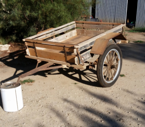

Here's mine. When I found it there was a late 20's Buick front axle and wheels under it, which the owner wanted to keep.
I had a blacksmith made square axle that took Ford wheels to replace it.
I replaced a couple of boards, spliced another to a broken side, and have left it as it was. I just need to make a hitch to tow it behind Henrietta. The drawbar is actually a model T frame rail.

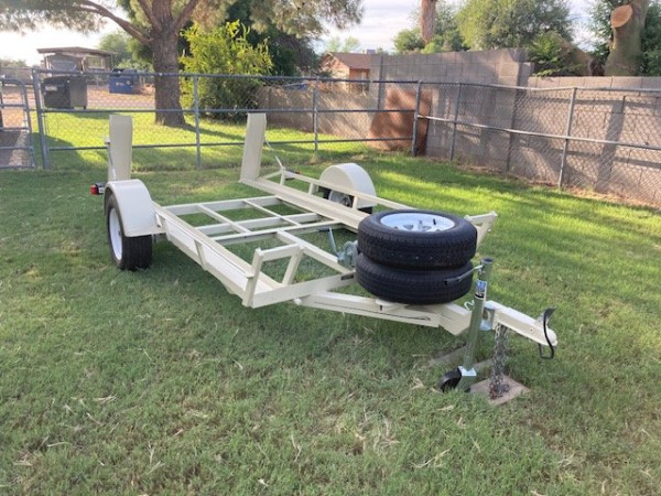

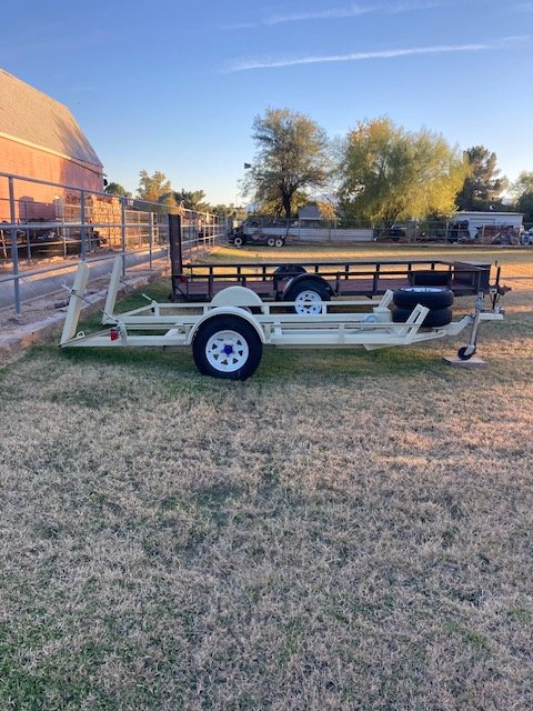

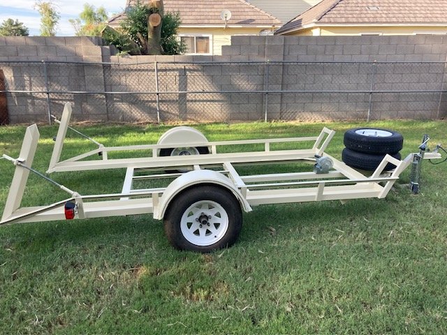

Hi Chad, I tried to post pics but they would not load so I will try again.
This is the speedster trailer I purchased from Joel it is one of two that Tommy Brawner built. It is only 500# & tows very nice. Don't have plans
but your car will dictate the dimensions. The two spares are mounted on the tong so it tows better empty.
Craig.

Craig, those are nice trailers. Being able to run the car up on up to a permanent stop makes tying the car down easy. All the tie downs do is hold the car against the stop. I have built five similar ones for myself and others. Mine do have a complete floor. It makes them mush more useful for other stuff, while adding little weight. Can you imagine how easy it would be to manually push/manouvre that trailer around without having tandem axles fighting against you. I do chuckle when I see two spares on a two wheel trailer though. How many people carry 4 spares for their car? In my lifetime I have can remember having just two flats on my trailers. The one spare has always been enough, although I did replace one while on tour, because I had more than 3000km before I was home again. No point in pushing my luck that far.

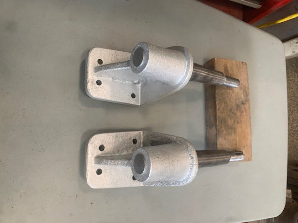

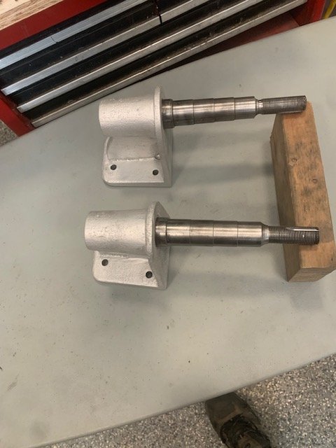

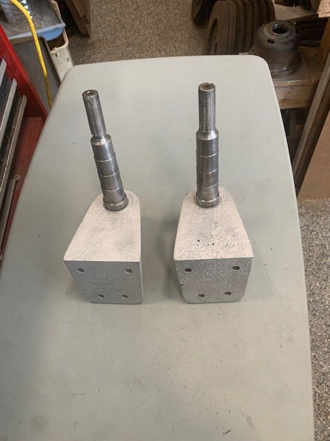

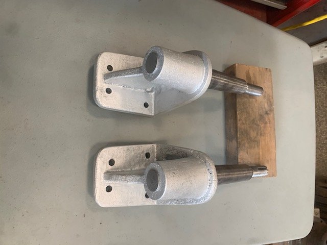

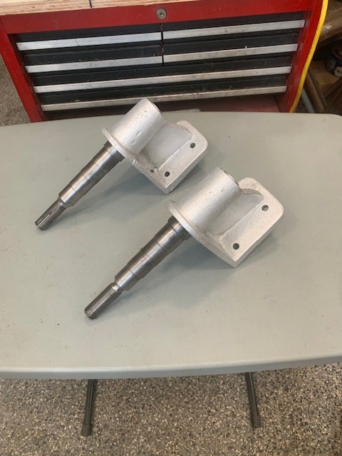

For about forty years, I have had these very unique spindles. They were attached to a wooden beam with T front wheels mounted. I recently took the wheels off, cleaned, bead blasted and primed the brackets intending to sell them. They are nicely machined to spec, T front left and right thread spindle shafts cast into a robust aluminum bracket. I have no idea who made them but I am impressed with the quality of manufacture. I have not chosen a price but, if anyone is interested, send a message with your phone number and I will call.
