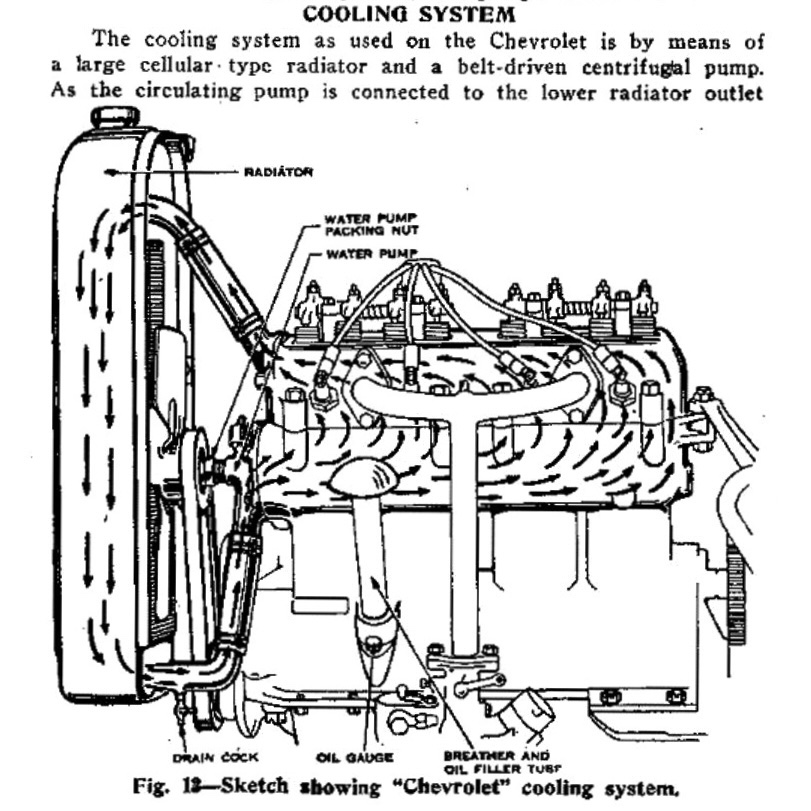

If you think Ford was bad, look at Chevrolet’s!
