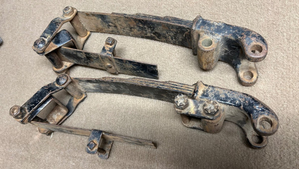

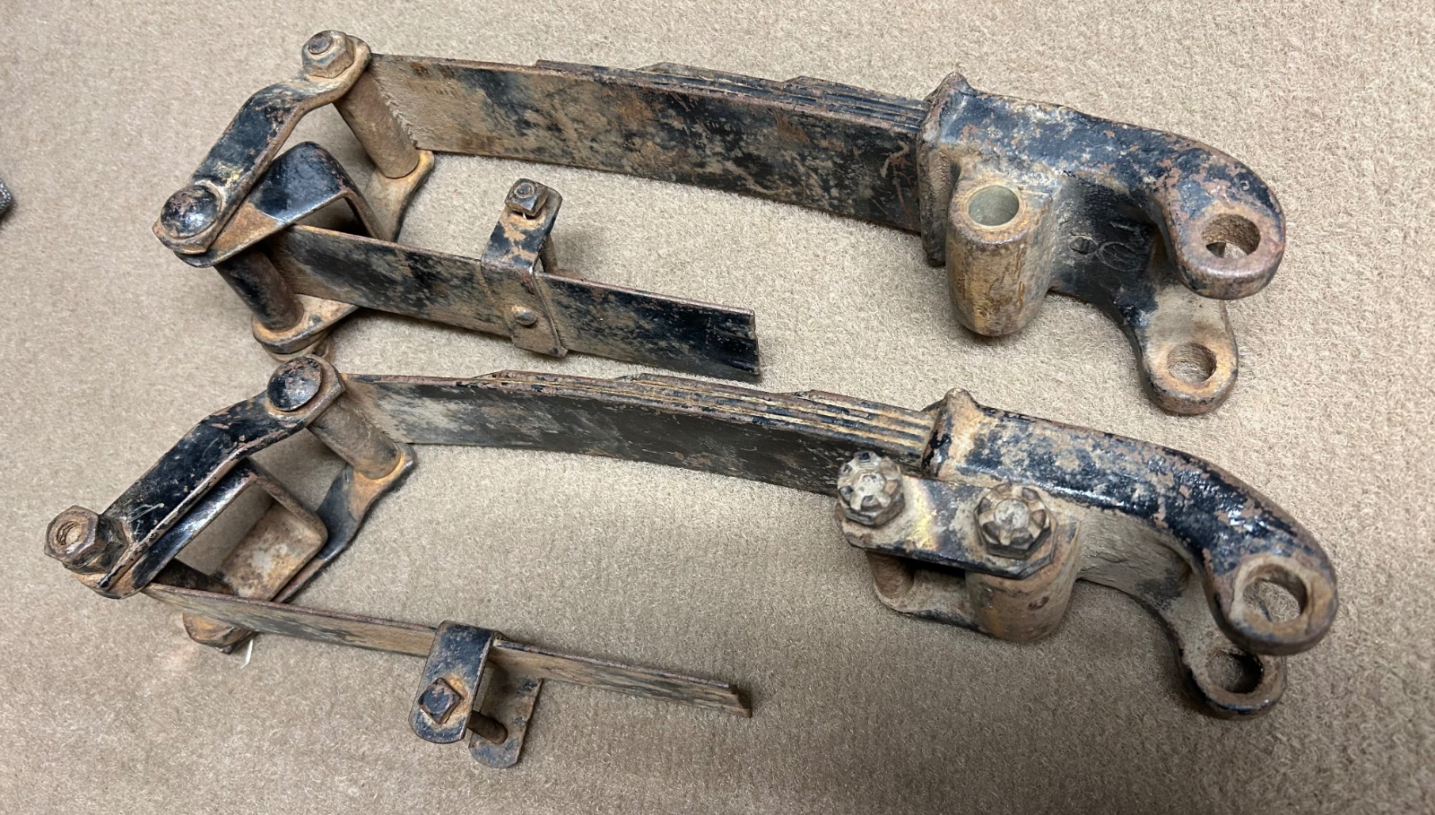

I picked these up at a swap meet. I was hoping to use them because my car tends to get overweight with camping stuff :-)
I looked up forum post and found the following
https://www.mtfca.com/discus/messages/1 ... 1292024995
I see that I’m missing the perch that would be necessary.
So I won’t be able to test these out unless I find that. So when you say lying spelled, the same What is the experience you have using these?
Do they really “work as good as they look?”
Or does someone just happen to have a few of these special perches lying around :-)
Matt

In looking at it, it appears that the perch you mention is not used on this set you have. It appears one mounting spot is inboard on the main spring, (which you seem to have intact on your examples) and then the outer connection is made from the original Ford Spring shackles, hooked up to the end where you say your perch is missing. It appears you actually have the perch, and all you need to do is connect up the Ford Spring shackles on the end of the Ford spring, and off you go!

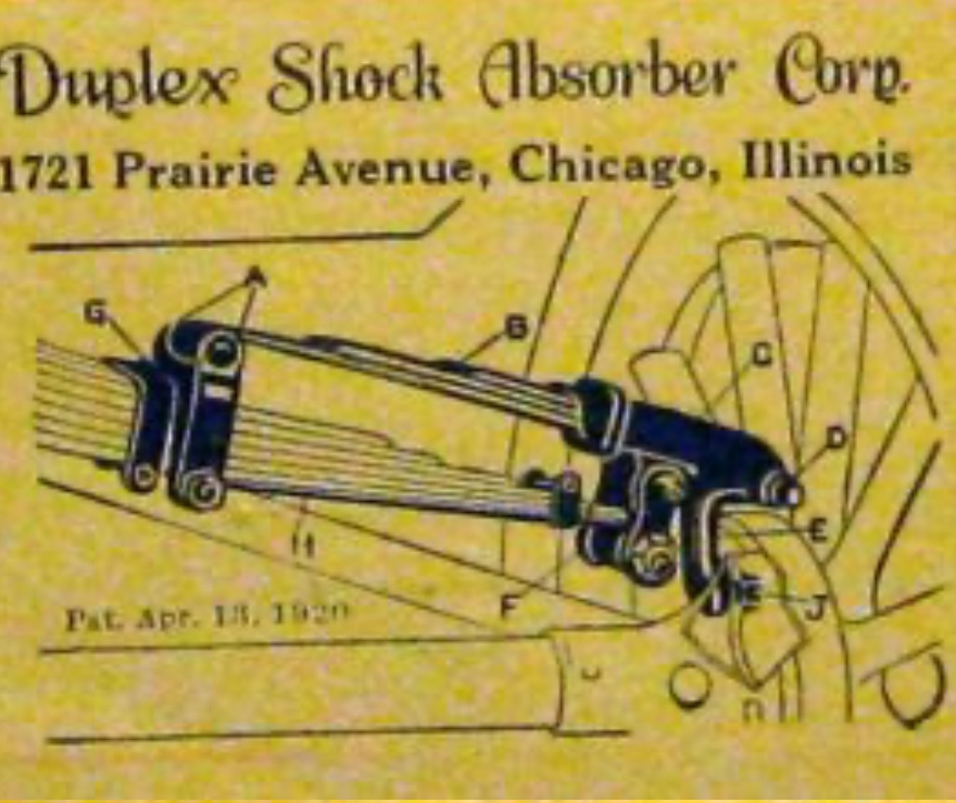

The perch on the outer end is a part of the accessory, and is reversed so that the additional piece is hinged outboard of the usual standard perch. The standard perch is not used.
I would not use them without replacing the inner linkage with more substantial links than the flat steel items shown in the advertisement. The holes are easily elongated in use because the load is taken on a rather inadequate tin linkage.
In my experience there are better examples which do make a difference.

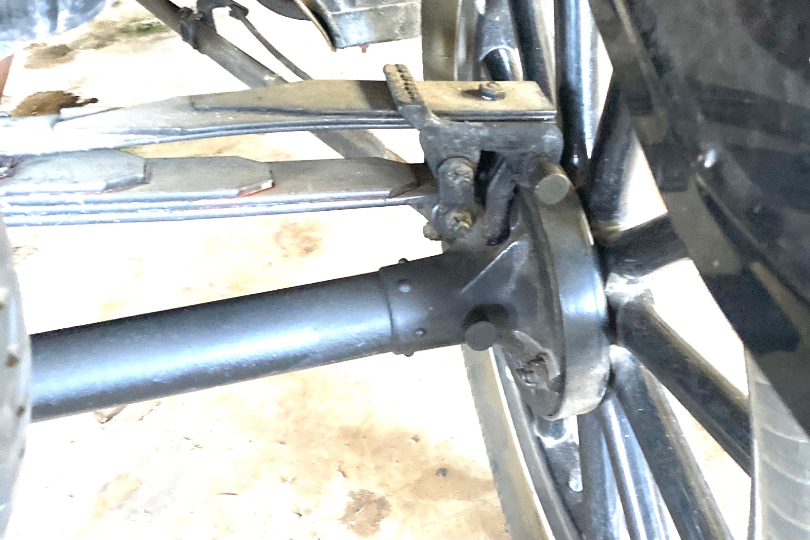

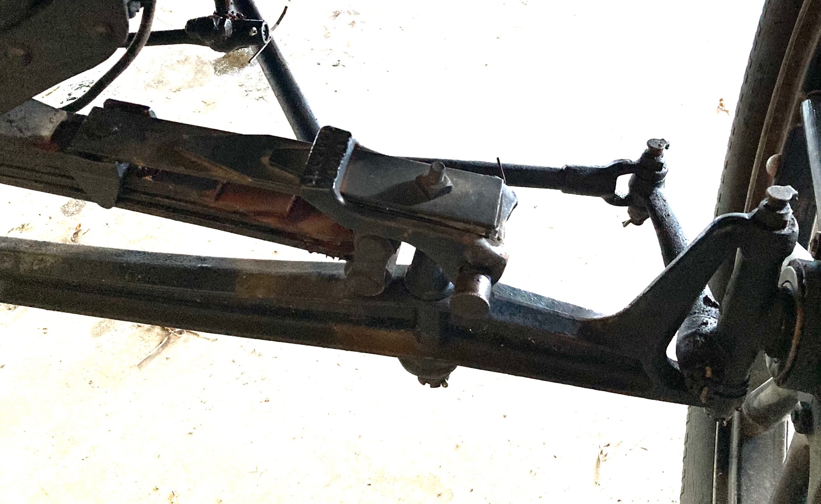

I like them on my centerdoor. It’s top heavy and I think they minimize swaying. Can’t imagine any utility value on a roadster..You’ll have to reverse Ford front spring perches and there’s a single ball bearing under both the inboard accessory bottom leaf spring-in grease-rolling on top of the Ford front leaf…But you Will use the Ford front perches.

Aren't these intended to counter act the stock spring to dampen the spring travel rather than act as a booster spring? If load handling capacity

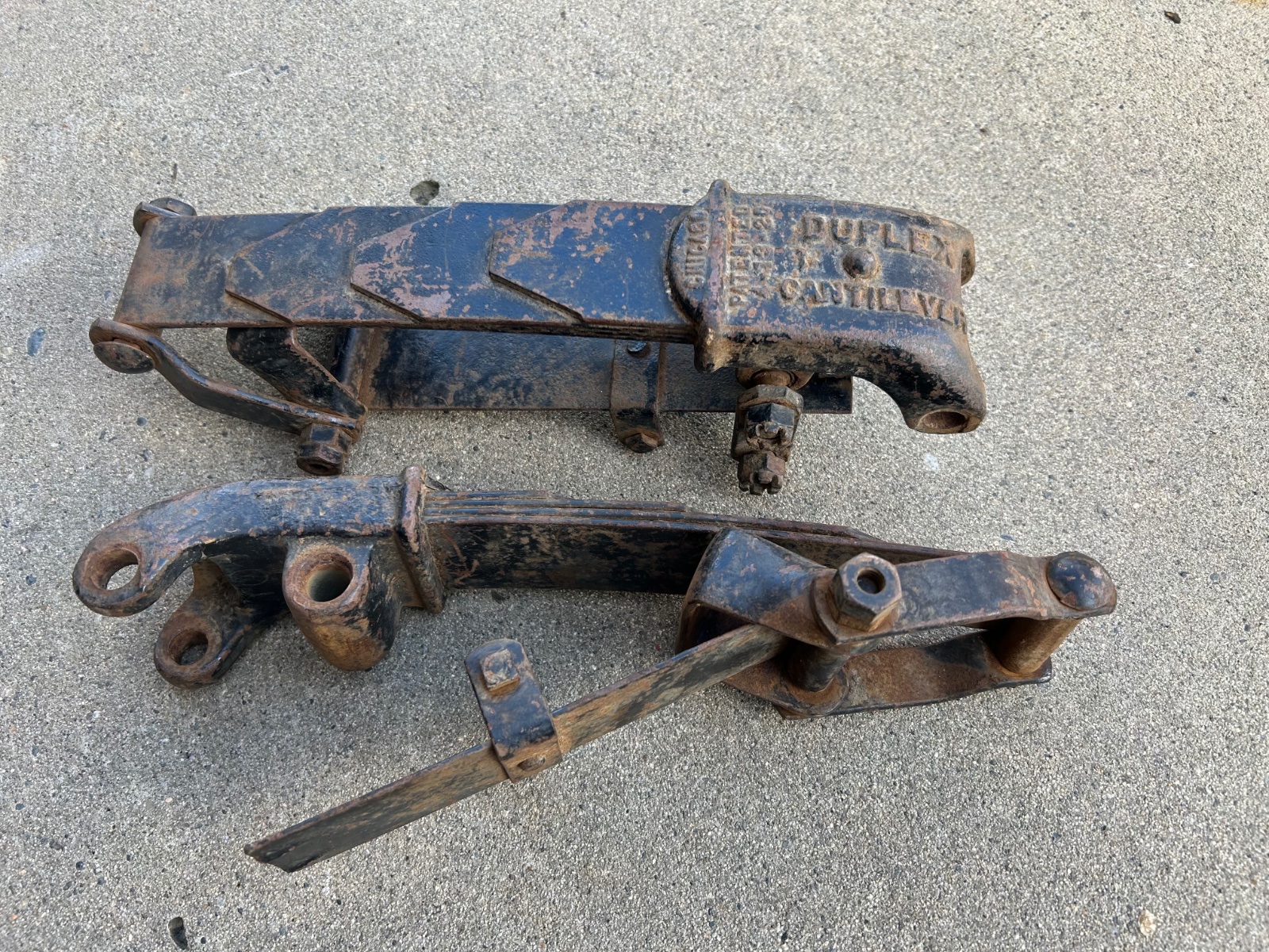

You have a point, these accessories can be removed and all that would be missing would be would be the original perches.
Henry,
I can only imagine how much it would cost to make it worth your time. It seems like it would probably be cheaper to find someone willing to sell a whole set like Dan mentioned. But if someone is just scratching their head because they have a scrap pile with two of these aftermarket perches …. I have a home for them or vice versa.

Matt , I don’t know which of your cars you are going camping in, but that type of auxiliary spring won’t work with a 1926-27 large drum rear axle. I at one time had a 1926 roadster pickup that had a 1925 small drum rear axle in it and a similar, but a little different , auxiliary springs. They worked ok but I ended up going to rear wheel brakes for better stopping and the auxiliary springs went to a new home. If your camping car is your 1926 touring car you can try switching to the 10 leaf spring out of a 4 door and see if that helps some with the over load.
