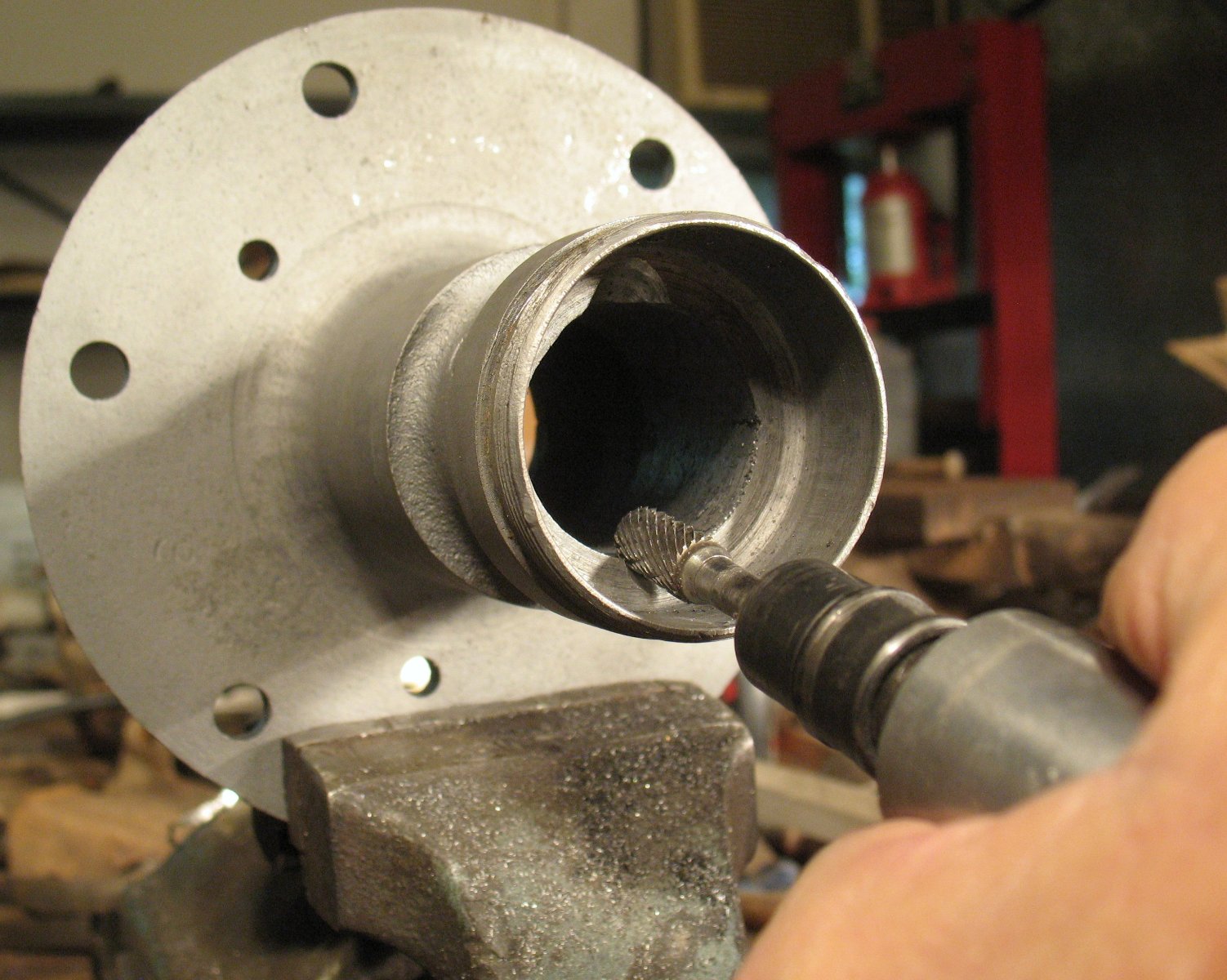

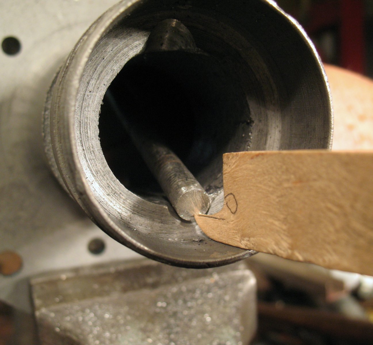

by Steve Jelf
Art, if by grooves you mean notches for driving out bearing cups, that hub is a later one made for Timken bearings. The ball bearing cups are wider and you don't need a notch to drive them out. When I made the front wheels for my 1915 (had Noah Stutzman make them) I used 1917-1918 hubs because they are heavier duty but still have the machined flange for a speedometer gear. They were made for ball bearings, but I added notches and used Timkens. The heavier hubs did not split. I don't hold out a lot of hope for your WTB ad. Some ball bearing parts are readily available, but others are made of unobtainium. That's the main reason I used the roller bearings.
Cutting notches for Timken bearings.
Checking notch depth. The stick shows that a drift pin will be able to reach a roller bearing cup.
