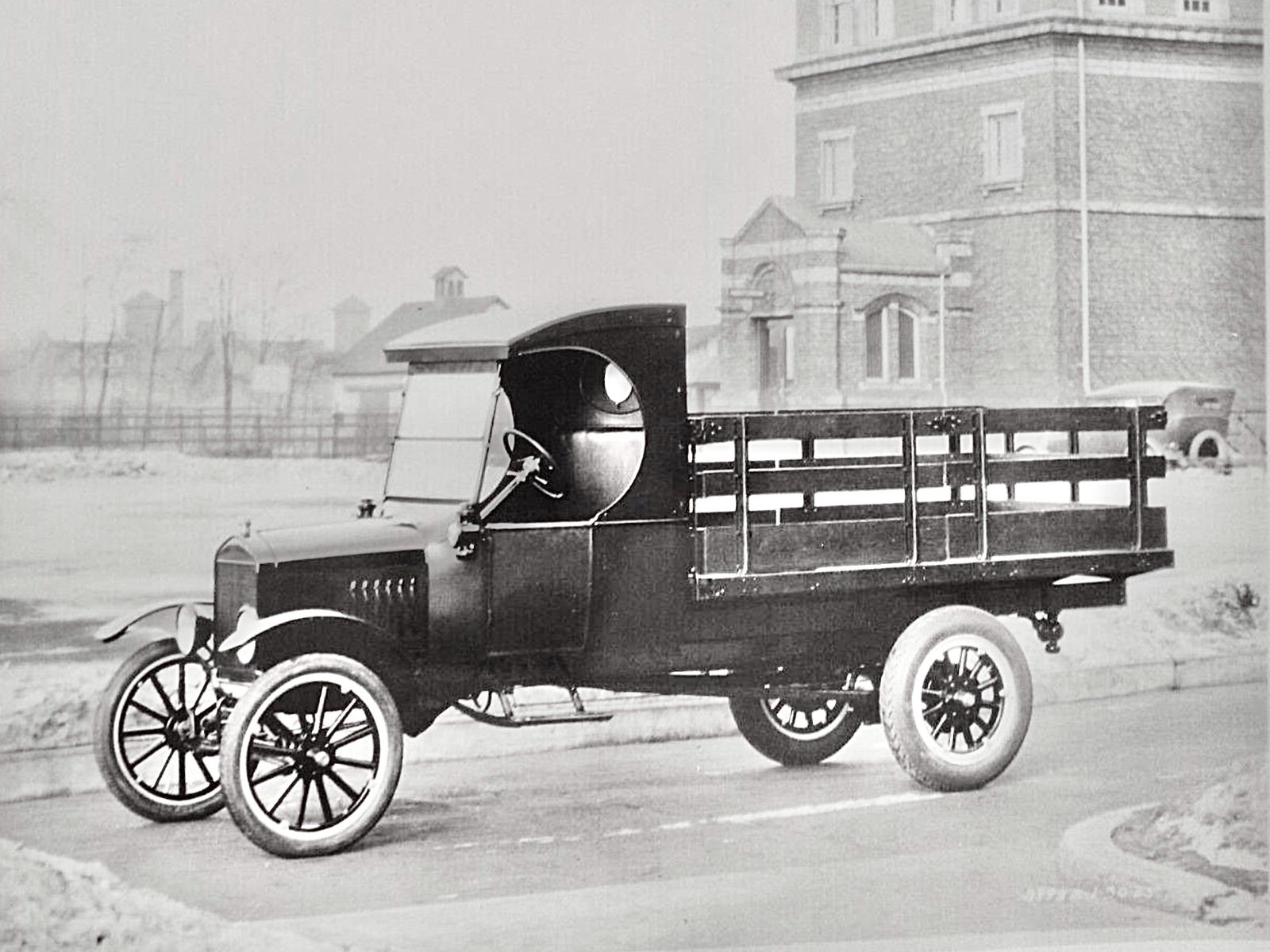

- Posts: 5599
Re: specific question regarding turtle decks on roadsters vs coupes.
I have my Gramps' TT C-Cab Express - high speed rear end gears & a Warford and I can cruise 35 - 38 most all day !
- Attachments
- grandpa's truck0001.jpg (27.44 KiB) Viewed 3625 times

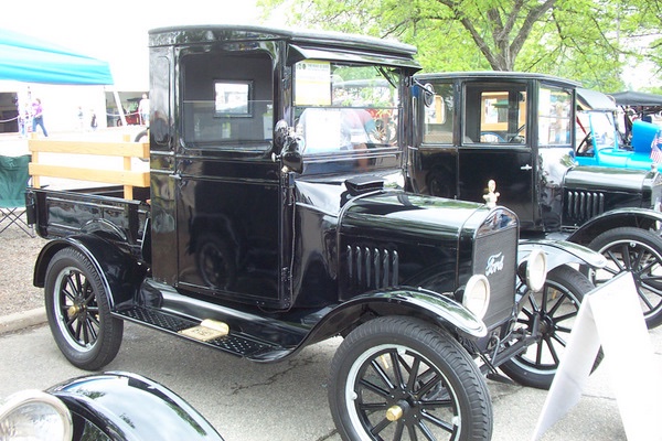

This photo from the recent Friday Fill up thread might provide inspiration for converting roadster body to C-cab.
Wayne Jorgensen, Batavia, IL
1918 Runabout
1918 Runabout
WillyR
- Posts: 359
- Joined: Wed Aug 21, 2024 5:24 pm
- First Name: Vilhelm
- Last Name: VonRaschke
- * REQUIRED* Type and Year of Model Ts owned: 1924 coupe
- Location: ABQ
ohhh, that's purdy right there....
