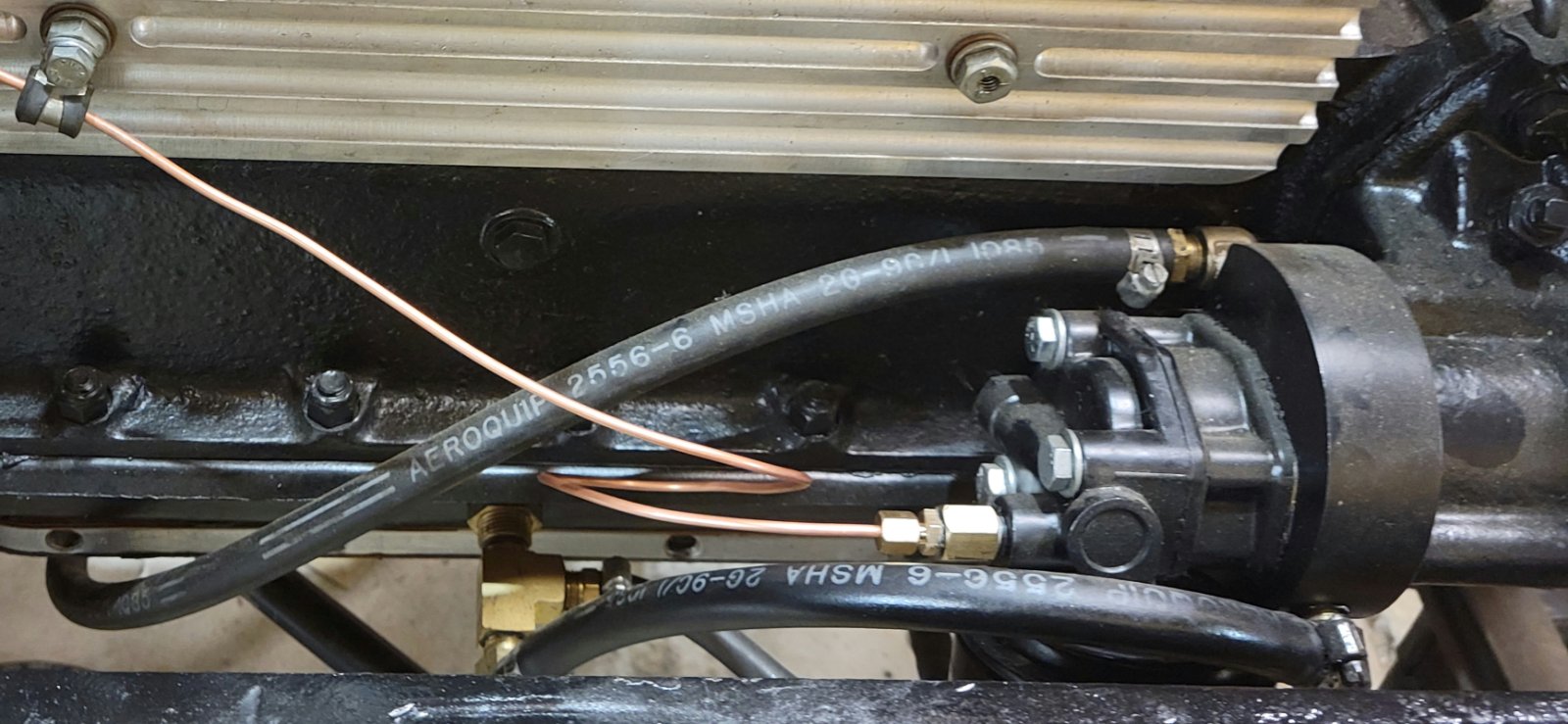

Posted: Mon Apr 28, 2025 12:16 am
by KWTownsend
Update pics...
Re: Oil pump pressure
Posted: Sun May 18, 2025 8:47 pm
by KWTownsend
I put in 5 quarts of oil. Is there any procedure for priming a B-210 oil pump?
Should I crank it over by hand and bleed the line until i get some oil to the gauge?
Posted: Mon May 19, 2025 1:12 am
by Kevin Pharis
I suggest pulling the coil wire and cranking it for a short bit with the gauge port open. Be sure to pre-fill your oil filter to ensure quick response. If no oil, possibly use a hand held vacuum pump do draw oil in from the gauge port
Posted: Mon May 19, 2025 9:25 am
by Henry K. Lee
I recommend filling oil filter completely, disconnect oil lines , outputs on pump, and fill with an oil can and turn engine by starter. Works everytime.
