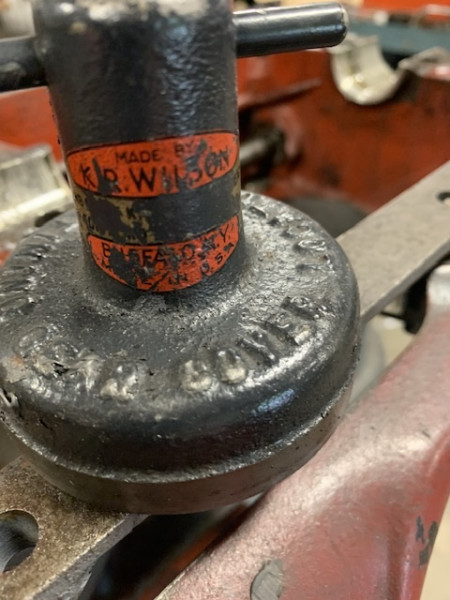

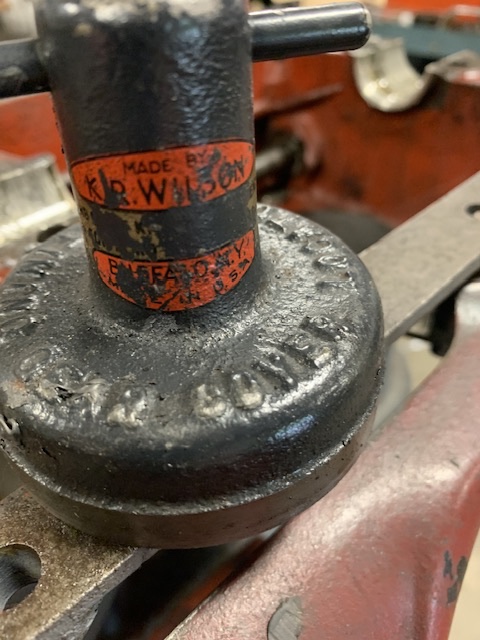

Does/Are any vendors selling Bob's style of alignment tool? If so, who is selling them??
TIA

Ebay seller "burnzoil" makes and sells them. He has also sold in the classifieds here, but it has been a while and I forget his username.

No idea, but I think any decent machine shop could make a simple alignment tool. Picture a round piece of metal exactly the diameter of a timer cover, with a hole exactly in the center that slips onto the end of the cam shaft.

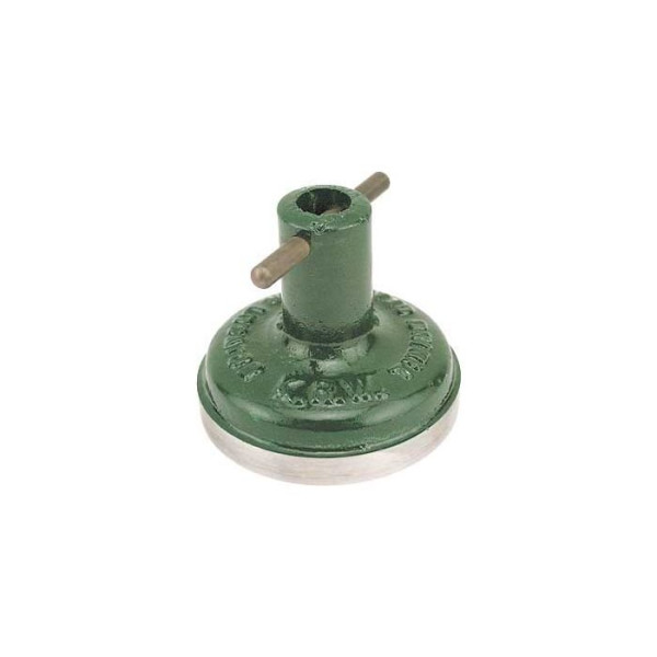

Lang's ran out of stock tools ????

K R Wilson sold them

The late Bob Scherzer reproduced the KR Wilson tool.

Gene French makes them.

Thanks Steve. I have two of the aluminum ones that index on the cam seal flange but I am finding those are hit/miss on whether they index correctly. I had a large one from years ago that Bob had made but it appears it is now MIA. I may just machine a piece of aluminum that will index off of that little one and the larger ring will slide over the small one.

Those are the ones Langs sells that used the seal area. My preference would be the KRW style. I too was going to suggest Gene French. Pretty sure he makes the style that indexes off the machined recess the timer fits into.
