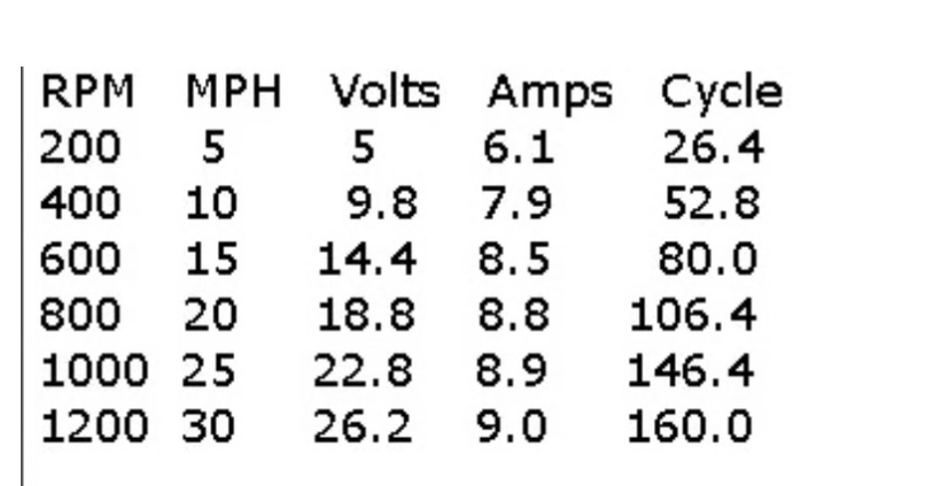

Posted: Fri May 30, 2025 9:57 am
by Lexveen
I was wondering what power the magnet has. With good, strong magnets it delivers a voltage of up to 30 volts or even more, but what current can it deliver? Has anyone measured that?

Ford listed info on the magneto, this chart was on the forum years ago, may not be entirely accurate as info is from the T days and measures were likewise approximate.
