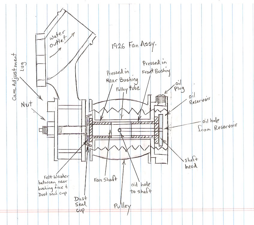

I replaced the fan hub in my '26 Runabout. I installed new bushings and had to ream (very slightly) to get the used shaft in. It took a bit of a push to get the unworn center section of the shaft to go past the bushing. It seemed to be an appropriate fit, once in place. I rubbed grease into the felt washer but the 10W-30 oil slung out quickly. I replaced it with 80W-90 gear oil and it is still coming out.
Is a new shaft my solution? An additional washer? Or should I pony up for a ball bearing hub and call it a day? I notice that the belt is running against the front flange of the hub pulley.

The original set up will hold oil when everything is right. Replacing the bushings and not replacing a worn shaft is problematic. I would suggest rebushing it and replacing the shaft, the fan blade gasket, and the felt seal and try again.

The convex shaped hub is designed to keep the belt centered on top of the hump of the hub. If the belt is riding toward the front of the hub, the front bushing is probably worn, causing the hub to tilt down. The oil you use needs to be thin enough to flow from the reservoir into the center hole in the shaft, through the tube in the center of the shaft and out through the hole into the gap between the bushings. A thick grease will only clog the oil hole. Using flowable oil should not leak if the gaskets and felt are fresh and the shaft is a close fit within the bushings. You can get fan rebuild parts from the antique auto parts suppliers.

Too much fore and aft play in the hub will allow oil to leak. Irregular or excessive wear of the pulley faces can cause the belt to run against the pulley flange. A problem with the belt itself also could. If the belt ran on a misaligned pulley, it may have irregular wear.
