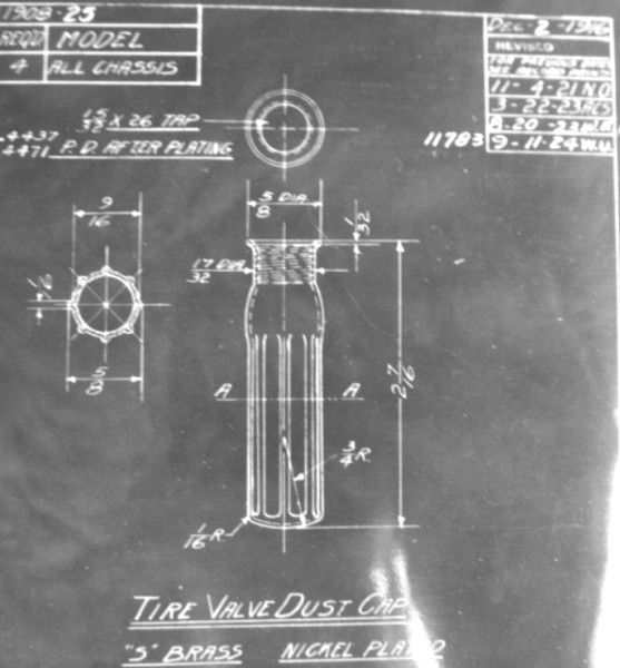

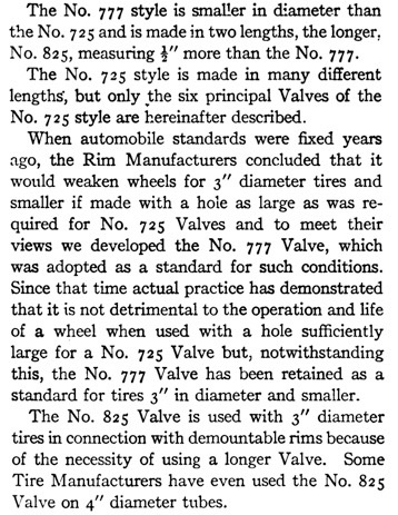

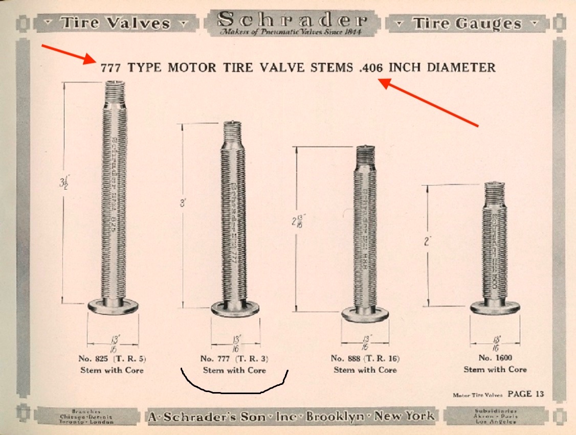

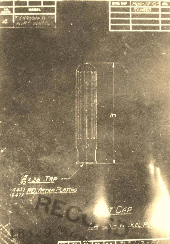

- Posts: 4107
Re: 1926-7 Inner Tubes
Here is the print for that 3" dust cap, note in the upper left corner " Chassis with wire wheels"
So the std. 777 was used on the wire wheels, longer dust cap as the rim of the wire wheel is thinner than a felloe with demountable rim.
Rational for the small .406" dia. stem of the 777 was due to early years 3" tires, but guess Ford stayed with the 777 for the Model T. The larger 725 uses a larger dia. dust cap.
- Posts: 4107
For ref. the std dust cap for the T ( without wire wheel) and using the 777 stem is 2 7/16"

Topic author - Posts: 3960
- First Name: Larry
- Last Name: Smith
Good Stuff! I usually like to keep my stuff as authentic as possible, however, I have a perfect replacement for the 777 valve stem. It's still a Schrader, but as noted above is 1/4" shorter. The valve stem is an 888. It uses the same bridge washer and nut. The reason I prefer this 888 is that most likely reduces the weight of the valve stem.
