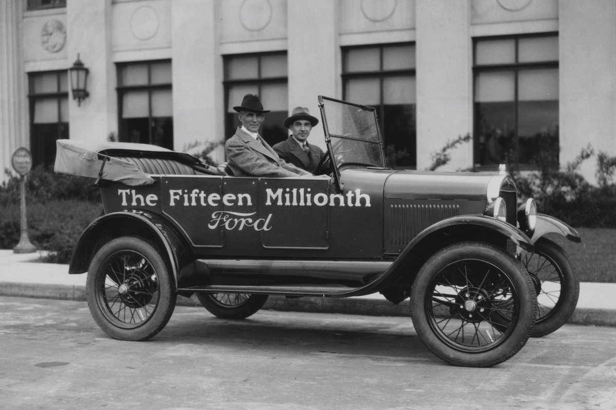

Researching wire wheels in the Ford Service Bulletins, they first appear in an article dated March 1926, vol7, pg19. The article states to use special tires and tubes for the wire wheels identified with the markings "For either drop center or flat base rims." So for early production wire wheel valve stems were long enough to be used for demountable split rims. More insight is provided in a small article dated January 1927, vol 8, pg 122, and states "It is also necessary to provide a longer dust cap for the valve stem, these parts being also obtainable through the various tire dealers." So for early 1927 production the wire wheels were still using the longer stems that fit the demountable rims. To try to determine if later production wire wheels used the Model A type shorter stems, pictures of the 15 millionth Model T were inspected and clearly show the valve stems covers are freakishly long. The Service Bulletins plus original photos of the 15M Model T would lead me to believe the Model A type shorter valve stems were never used on wire wheels during Model T production.

Jeff, that is is logical, it could possibly be correct! :D :D
