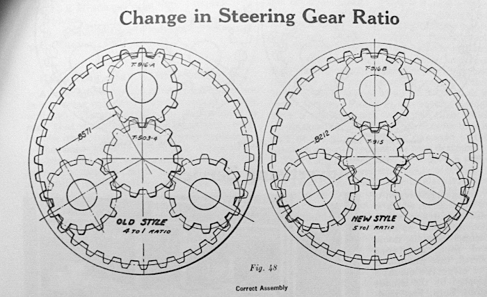

Here's the info:
The important item is the steering post, that has to be the late 5:1 post, as the pinion pins are different center lines than the 4:1 post, that will make it impossible to fit 5:1 gear set.

I’ve also read that the grooves in the gearcase to limit shaft rotation are different between the 4:1 and 5:1 units.

Another difference not mentioned because of tire width.
Re: 5 to 1 steering
Posted: Sat Jun 28, 2025 7:44 pm
by Jerry VanOoteghem
TRDxB2 wrote: ↑
Sat Jun 28, 2025 2:43 pm
It was mentioned, but thanks for the pictures.
