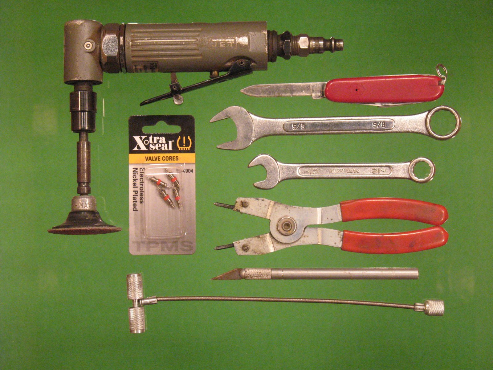

I suppose this is a silly question, but have you removed the valve core from the stem?
The tool at the bottom (core wrench) is for installing or removing valve cores.
